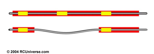

How important are pushrod guides? Do you really need the whole tube, or could you get rid of part to prevent binding? I made a stupid mistake and decided to use the pushrods that came with my kit. They make a slight bend through the fuse, and are being held up by the tubes. The surfaces move great, but the last little bit is not returning to center. I want to get rid of part of the tubes, but leave about 2 inches on each side of the bulkheads. I figured I would ask around to make sure I don't do something that will comprimise the safety of my plane.

The guide tubes are designed to provide support. I would not suggest that you remove any of the guide tube material between the bulkheads as this will most certainly give the pushrod room to flex. If the pushrod is binding, you need to find the problem and fix it.

Ditto, The guide tube is there to prevent the pushrod from bending. It can't bend if it's hitting the inner walls of the outer tube. Remove a section of the outer tube and the pushrod can bend
