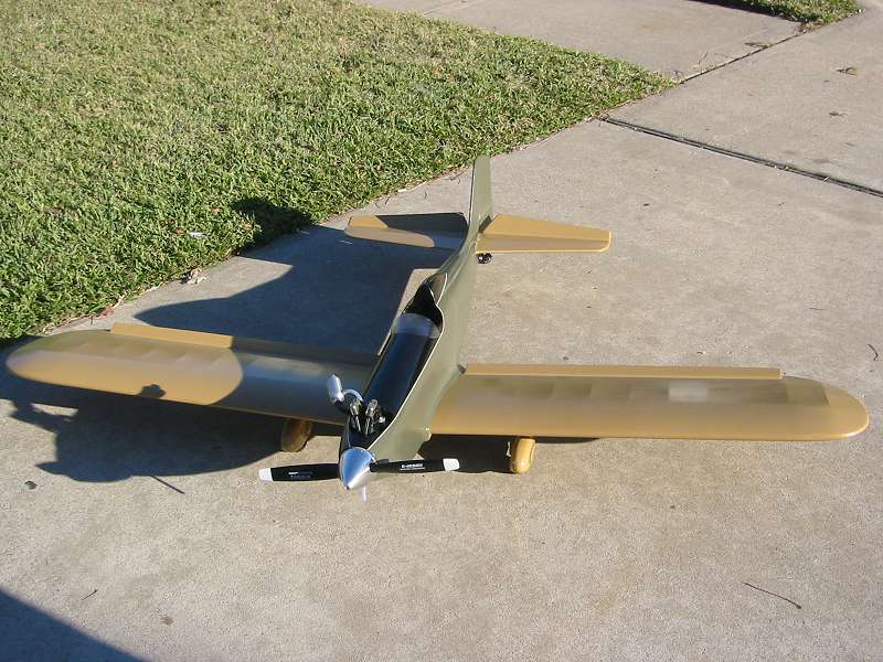

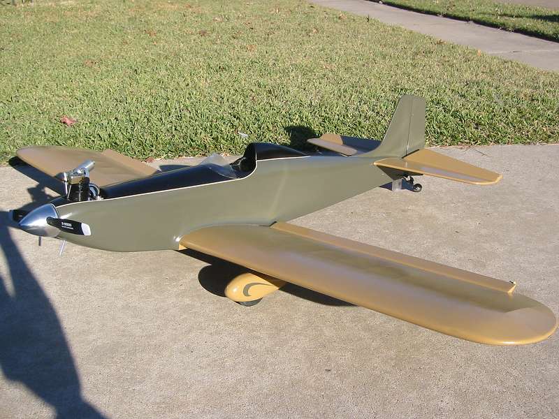

I just finished one not to long ago...I put a saito 91gk in it. It is a tail dragger as well, fuse has been glassed and the wing was clothed.
Good luck.
charles
