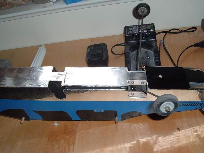

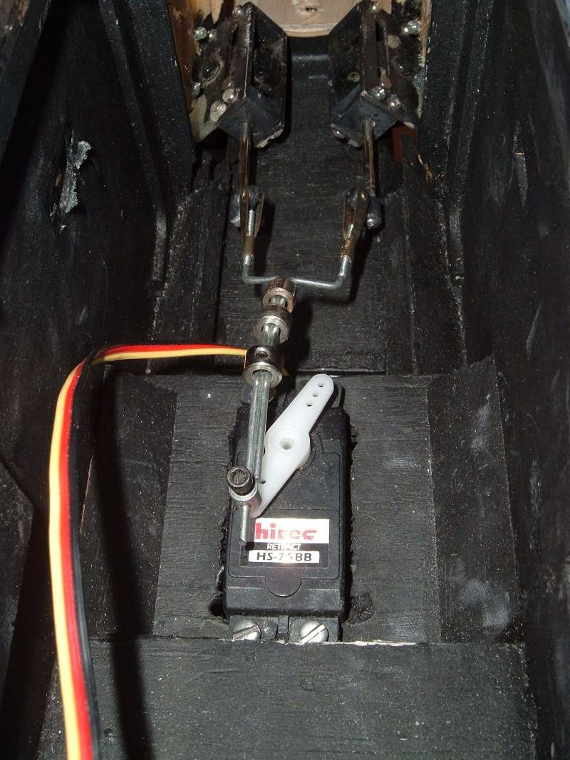

I have a trainer w/retracts. I converted it to a taildragger and the wheels fold rearward. The retracts are mounted at a 45 degree angle inside the fuselage just in front of the wings. If you want pics let me know..

Here you go-
The pictures explain most of whats going on with the setup- But if you have ant questions let me know..

This is a plane I use as an advanced trainer for students until I pulled the gear for another project. I built it with retracts and huge flaps in order to incorporate all six channels of the radio I was using..

Thanks; with the exception of retracting rearward instead of forward, that's pretty much exactly what I was asking about.
