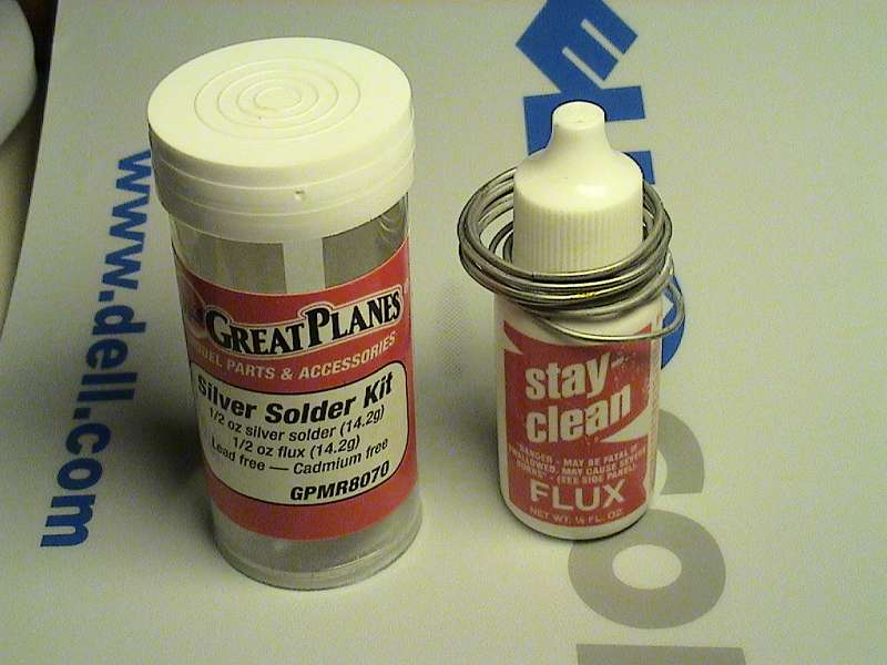

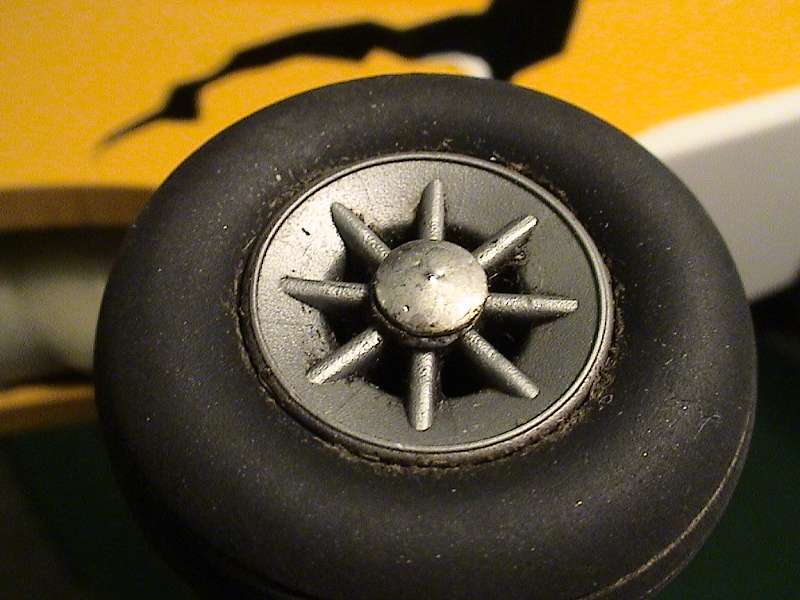

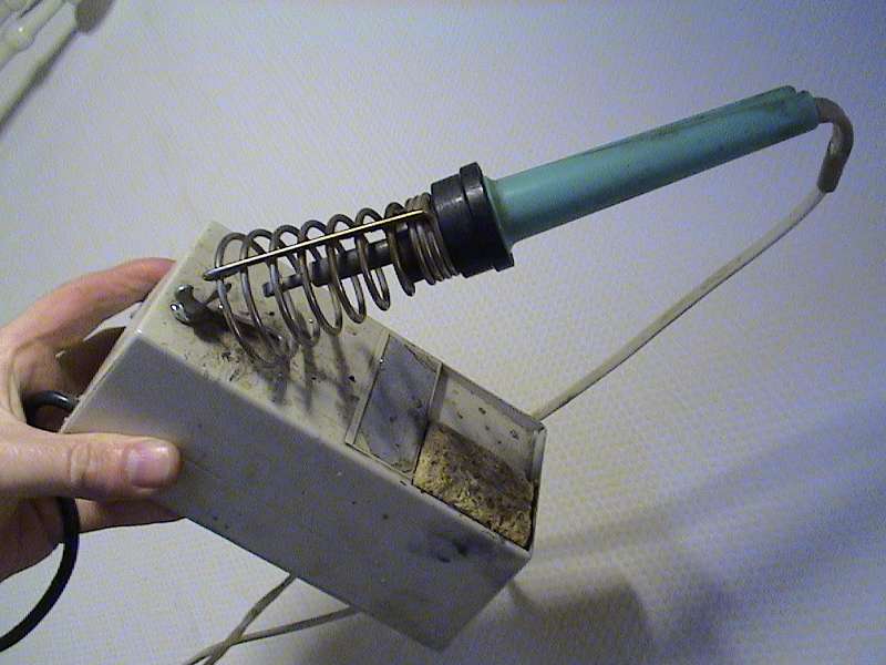

Old 03-29-2005 | 01:54 PM
Posts: 7,816
Received 10 Likes on 10 Posts
From: Upplands Vasby, SWEDEN
Default RE: Wheel collar problems??????????
Hi!
Why use wheel collars when soldering is so much better...and easy....!
Regards!
Jan K
Sweden

Old 03-31-2005 | 11:29 AM
Propwash in Pa's Avatar
Joined: Dec 2004
Posts: 213
From: Downingtown, PA
Jaka,
Nice job. I don't think there are many of us left.
John 373786
Old 03-31-2005 | 09:52 PM
JohnBuckner's Avatar
Posts: 10,441
Received 11 Likes on 11 Posts
From: Kingman, AZ
Dittos to Jaka's suggestion. I discarded collors long ago. You will never loose a wheel using this method and you don't have to file a flat on the axle. Once you do it its very easy to remove or replace the wheel. For plastic wheels, slide the wheel on and cut a small hole in some paper card stock and push this ove the axle then the washer and solder. After cooling cut out the card stock with a #11 blade and this will protect the plastic while soldering and provide the perfect lateral spacing for the wheel on the axle.
The axle can then be ground off much shorter (handy in some retract setups and certainly look a heck off a lot better.
John

I used Jaka's method today and it worked great. I still have the inner wheel collar since its there and seems to be holdin fine, but the outter is no soldered and there is no wheel wobble at all!
Todd
P.S. I don't have a moster iron either, just an eight dollar one.
