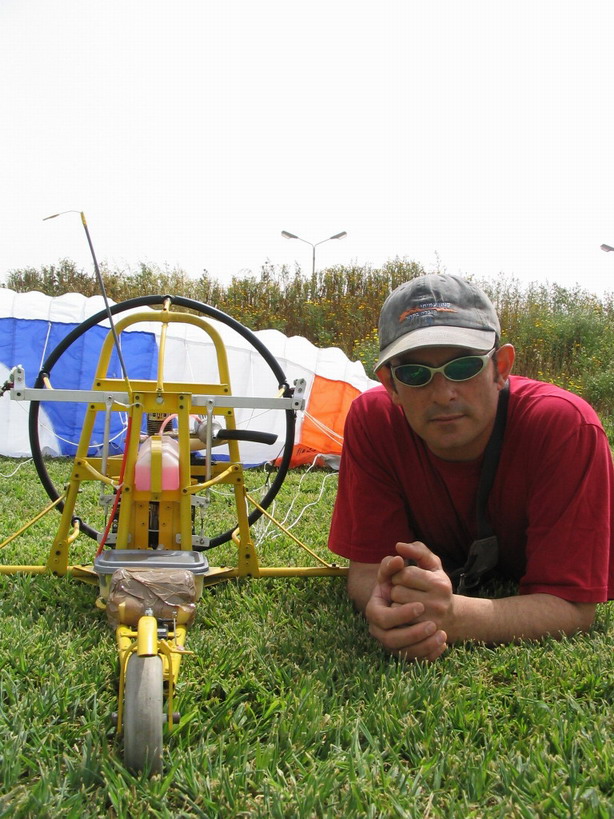

hi all...
i've got a pusher form paraglider with an O.S FX 46 and a 10X6 pusher prop on.
the problem is that the engine gets really hot after 2 or 3 minutes to a point where it can no longer
work
is there anything i can do to make it better????
thnks
yoav.

10x6 seams a bit on the small side. It will run a 11x6 Have you tried riching it up a couple of clicks. I run 12.25x3.75APC props on my 46FXs.

1st guess is that it is running too lean. Other things to check are that all screws are tight. Don't be embarrassed if you find a loose screw on something. It's not uncommon.

No additional heatsink or heli head is required. Remember our small glow engines are getting the most cooling from the methanol in the fuel not by the air itself.They are so to speak semi liquid cooled. So don't run it too lean. And don't use more than 5%-10% nitro.
10x6 is to small prop...put on a 11x6 APC.
