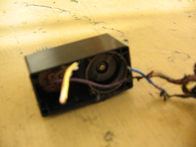

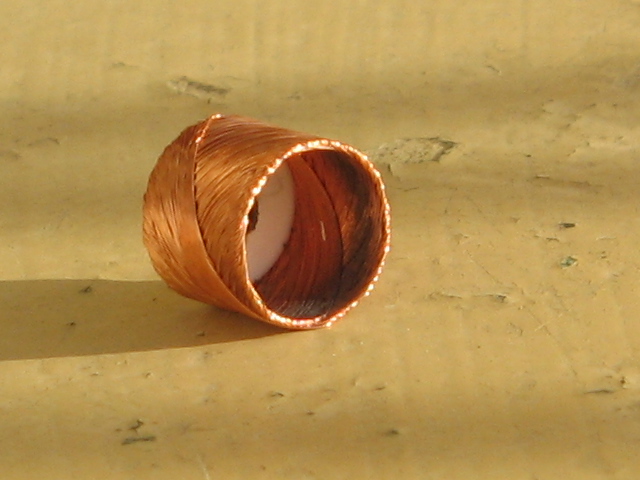

Coreless is the way the servo moter is set up internally and it works very well with a lot of speed and power. I think just a fancy name for an electric motor. Instead of the usual motor setup the armiture is a drum instead of a solid core. The core is the magnet and the armiture is a copper windind. see photos In the second photo, the shaft in the center of the magnet is conected to the drum and is the output shaft of the motor.

very much like a brushless motor, except the core isn't a permenant magnet. Since both magnets are electo-magnets, the servo has to be on to have any drag on the control surface. Typically, with coreless servos, if they are turned off, there is very little opposition to moving a control surface.

The brushless still has the windings rapped around an iron core. The coreless does not. The copper windings that you see in the photos is the bit that turns attached to the shaft that goes up the center of the magnet, the magnet is fixed in the motor can.
