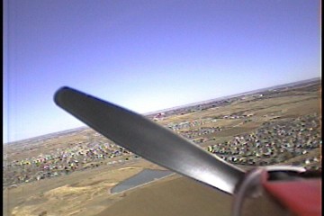

Here's a still shot taken from my video system:

I guess it depends on what you want to accomplish. At 1000 feet you get a pretty broad view of the ground. If you want to see into that pretty girl's backyard, you will need a zoom lense
The 53 degree lense gives a good perspective, not so wide that it becomes a fishbowl, but not so narrow as to limit what you can see.
