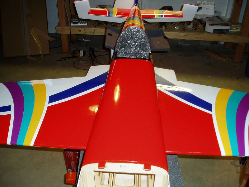

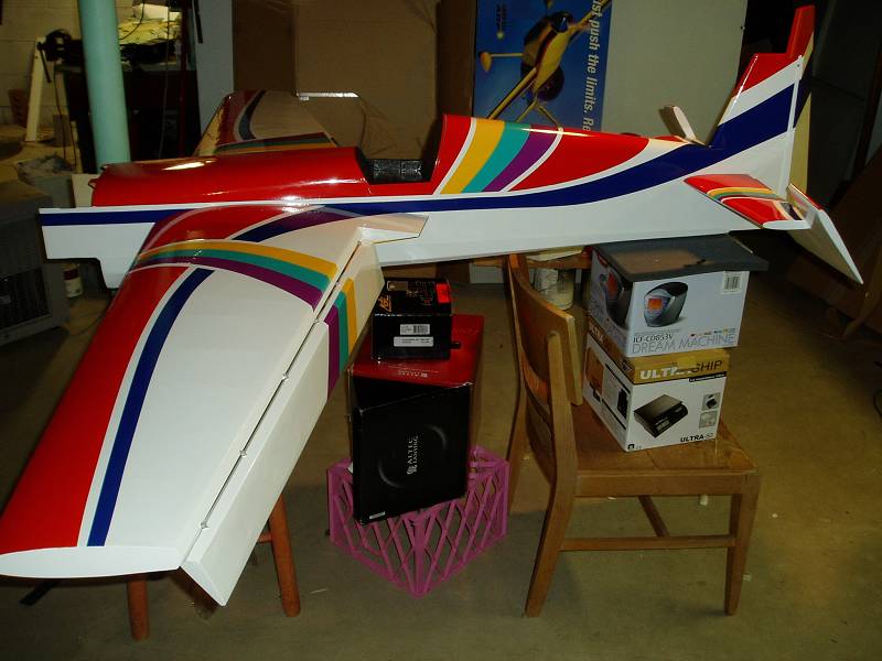

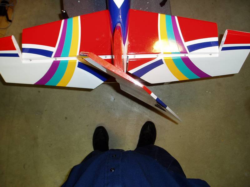

I have never covered a plane so I am not good at it. I have an ARF and would like to re-do some parts. My 1st concern is being able to cut the curved shapes. I can't imagine doing it with an exacto knife and having the curves come out nice an smooth. So how do I cut the shapes? I will cover the rainbows with a matching blue (see rest of plane).
Also once the pieces are cut can I just use that covering solvent and avoid the iron? I'm not good with irons, I always get air bubbles and/or creases.

I've found the best way to get good curve is on a great planes building board with an exacto knife. It has to be a new blade. Your base color should be ironed on but sovent will work. aditional colors on top of the monokoke should be alpied with solvent. If your having air bubble issues you should go over the suface with a wood pecker. I've found that with a really hot blow gun 99% of air bubbles will go away. My big problem is the schems around control surfaces.

To cut out you can try to cutting on top of the piece of glas. I only covered several times but this method works good.
Also to avoid the bubbles you can spray windex on the glue side and apply it to the model.Then use your credit card wrapped in paper towel as a squigie and get all air bubbles out.Then all you'll have to do is seal the edges with hot iron.No bubbles !

However over a period of years a sheet of glass, a metal straight edge, and a sharp Exacto has worked best for cutting monocote. Incidentally the glass came from an old storm door.
I also make paper templates for almost everything. If the template cannot be cut with an Exacto then scissors will be needed. I keep cuticle scissors and regular scissors handy.

Your first quest is to find out what the plane is presently covered with. If you use a different covering, the color won't match.
Next, if it's Ultracote, Ultracote has a nice paper backing that you can draw your designs on before cutting (Don't forget to draw a mirror image) - You will still have to cut by hand, but having lines makes it easier (You can use sharp sizzors too). The bad news is, trim solvent doesn't work on UC
If it's MK, you CAN use trim solvent, but you'll have to make templates to get the cuts right

Here are the results of my little project. The pictures are posted at the bottom of the page of the following link. I am more than pleased with how the plane looks with the new trim. I didn't do that great of a covering job but I guess I never do. And that's why I buy ARF's.
http://www.rcuniverse.com/forum/m_30...19/key_/tm.htm
Minn: The trim solvent did not work as well as I thought it would but it did stick. If you pulled up again it didn't stick as well anymore. It was a real pain. I ended up using an iron to get the edges to stay down. If I had known the solvent didn't wok on Ultra coat I would have just used the iron and saved myself the frustration (stunk up my house pretty good too).
flyboyz: To remove it was as simple as getting a little corner going and just gently tug it off. I tried not to rip it since I needed the pieces as a template to make new ones. The Ultra coat is way better to work with than the China coat crap they put on some of these ARF's. You can't even iron out the wrinkles.
