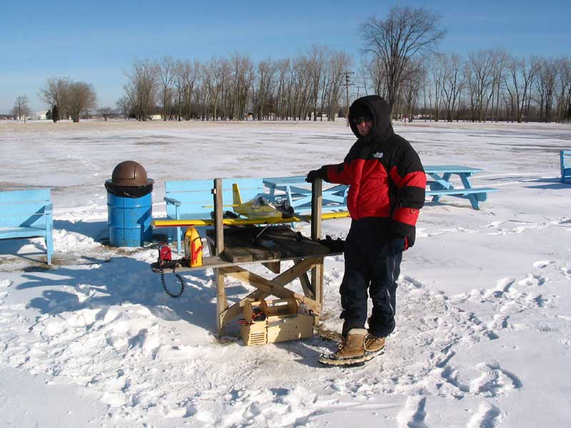

January 1, 2004, Minneapolis, MN. A really warm day at 18 F. Yep, that is a flying snow shovel....
