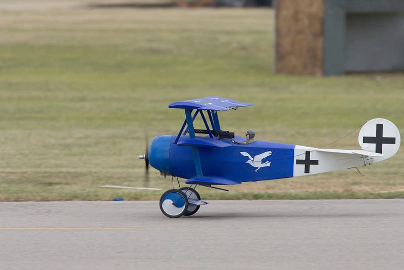

I used Nelson colored Light Fab on my BUSA Fokker Dr 1. It went on easily, pretty much like Solartex or the old style Coverite I have used. I have had a couple seams loosen up. I can't compare this to the other fabrics because I have always painted them. I wish I had top coated it with clear because the weave does collect dirt and grime. The little wing between the wheels takes a lot of abuse from the 2-cycle glow exhaust, but it is still on there. Plane is three or four years old.[img][/img]

Thanks for the input. Your plane looks great with the prefinished covering. Personally, I like to paint my finishes and I was really wondering about the LiteFab that was meant to be painted. I take it that you haven't used that product? Perhaps someone else might have given it a try. How about it ya'll ... anyome using or have used LiteFab with a paint finish???
