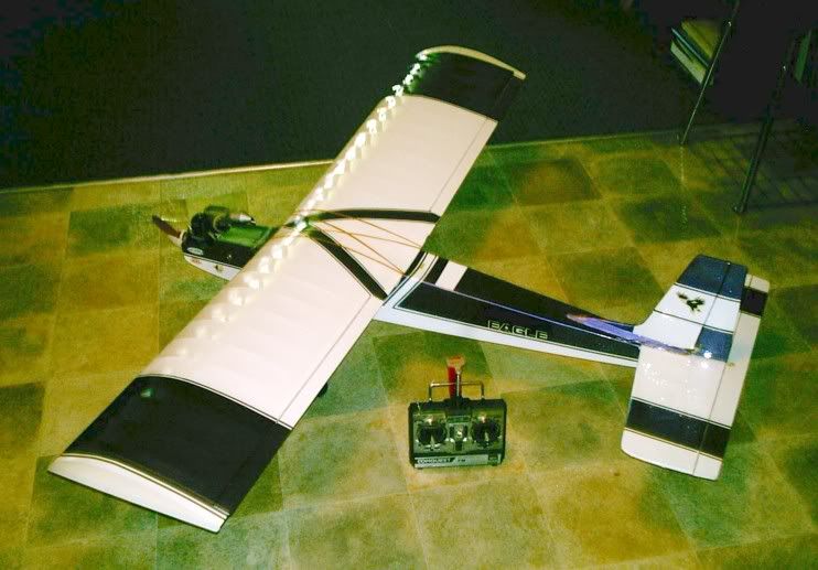

I thank you so much for the links and videos. I have a 16 year old Goldberg O.S. 40ts Eagle, and the covering that was on it is getting to old for my liking. The Mono-Kote is real brittle, plus she has too many patches on it.... so I stripped the wings down to the Skeleton except for the Ailerons. I never covered anything except the Tissue and Dope planes that I used to get when I was a kid.
I'm studying all the video's and I will read the directions on the Ultra-Kote and I'm going to make a attempt to do this. If I do a great job...I might do the Fuselage... however that isn't too bad and only has a couple patches. We'll see, wish my club would help me, but that's OK, I taught myself to fly somewhat, and I have you people here thank God!
