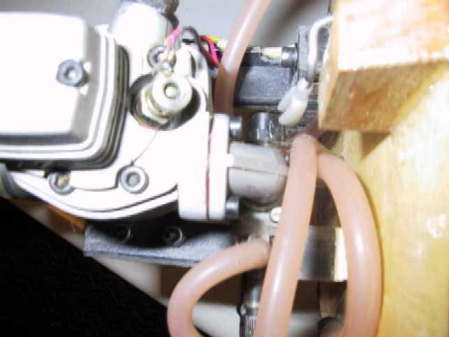

I have been making the remote glow plug connectors for years and use a small wheel collor on the business end of the glow plug. The wheel coller set screw holds the colloer in place . THe wire going to your remote connector is soldered to the wheel coller. I have used this method for years on 2 and 4 stroke engines with good results.

Here is a picture of the wheel collor on the glow plug . I used 2 pieces of telephone hookup wire to carry the load to the remote on ther fuse side. This is an inverted engine set up on my Nosen 40 size Champ. Hope it helps

Interesting......
I will keep that in mind if I can't get this stupid sullivan to work. Thanks.

I do the same thing as r1morris. Cut the connector off and solder on a small wheel collar (file a spot of the plating off first). I cut a very small piece of silicone fuel tubing and slip that over the electrode and then tighten on the wheel collar. The tubing is just a little insurance that the collar doesn't touch the base of the plug.
