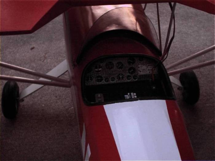

Does anyone know how to do engine turning on aluminum.
I think it is also called damascusising. Anyway it is the swirls on aluminum similar to the way the cowl on the Spirit of St Louis looks. I have tried every type of dremel tool but they cut too deeply. My best luck has been with a rubber eraser, but as the eraser wears the size of the swirls changes. If anyone knows about this procedure it would be appreciated.

I have done it one time with good results and a instrument panel.
What I did is get some of he soft polishing tips for my Dremel get the Cone shaped ones and cut the tip flat smaller then the swirl size.
Now in a drill press where you can control the pressure lay down the part and swirl away, as the tip wears add pressure to keep the size the same.
A little practice and you can get a nice look
The pic is kinda dark hope this helps
Den

Posts: 2,050
From: huron s.d.
Default Engine turning
