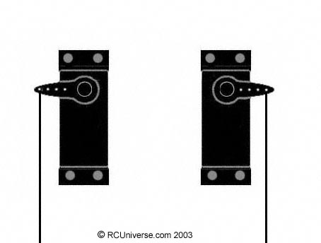

i have a P47 thunderbolt that i just bought. For the alerions it takes two separate servos. I went to hobbytown and got a "spliter" i believe is what he called it. I hooked everything up, and now there acting like flaps or something ( moving the same direction). On the spliter there is an adjustment, but its just....liek trims out both alerions, it doesn't reverse the servos. I have a Hitec Optic 6 radio, is this something i can fix with my radio, or do i need to run the alerions seperate??? please help im ready to fly this thing...

What you need is called a Y-harness. From what you say it sounds like you have what you need. Both servos will move the same direction. What you need to do is attach the pushrods to OPPOSITE sides of the servos. Either place the pushrods on the outsides of the servos, or the insides of them. This will ensure that you have the proper movement of your ailerons.
Hope this helps

It almost sound like you bought a reversing Y harness. If your set up already looks like what Ken posted. Then you need a normal Y harness.
