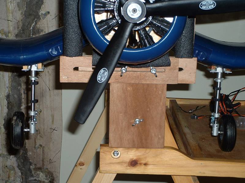

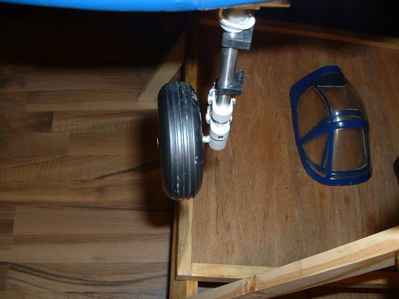

I was a little over zealous with he amount of toe in on my sons H9 corsair. I had put some toe in because i have mounted a RCV 90 in the corsair wich produces alot of torque on take off roll i heard. So i thought a little toe in will help tracking on the ground and on take off roll. I haven't maiden this plane yet but taxi test and just rolling the plane on the ground there is quite some resistence due to the toe in. How do i get JB weld to soften up so i can take out some toe in.

It doesn't look like much toe in in the pics. Or is it just me ?

Unless that toe in is very excesive, I doubt that it is adding much resistance. I'd suggest leaving it in (it will help in several aspects) until you fly the model a few times and get a feel for how it handles on takeoffs and landings.

Am I seeing set screws on the axle housing of the struts? Just where did you JB Weld? Shouldn't there be some adjustment between wing and wheel or is that just "scale dressing" in all the various collars and fittings?
According to CJ instructions they tell you to ad some JB weld on the bottom of the strut behind that set screw. I can losen that screw right off and those axle housings will stay put. Maybe i'll try some better taxi tests once the nicer weather sets in and the field finally dries out. Thanks for the info guys.

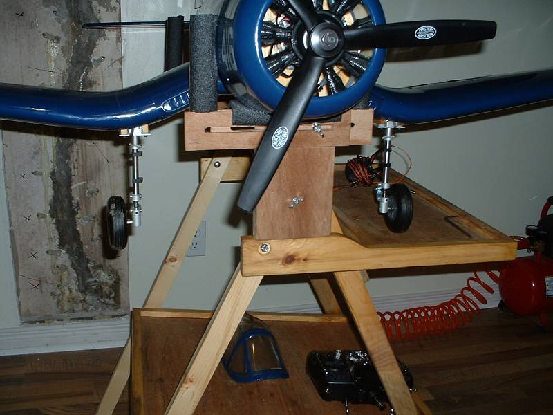

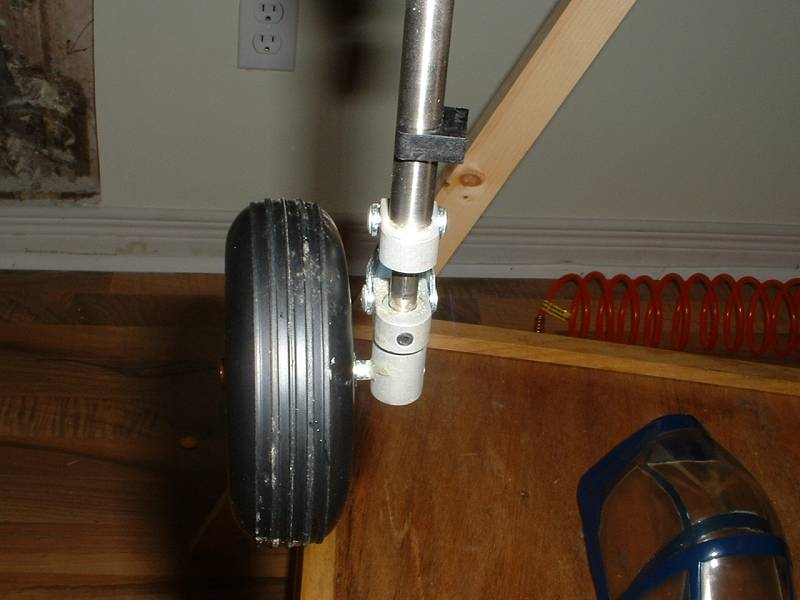

I tried to get some better pics.

Q: How can I remove J-B Weld after it is fully cured?
A: When fully cured, J-B Weld can only be removed by grinding or filing it off, or by directly heating the product above the 600 degree maximum temperature threshold.
This is from the J.B. Weld website.

I would wait and see how it taxis
