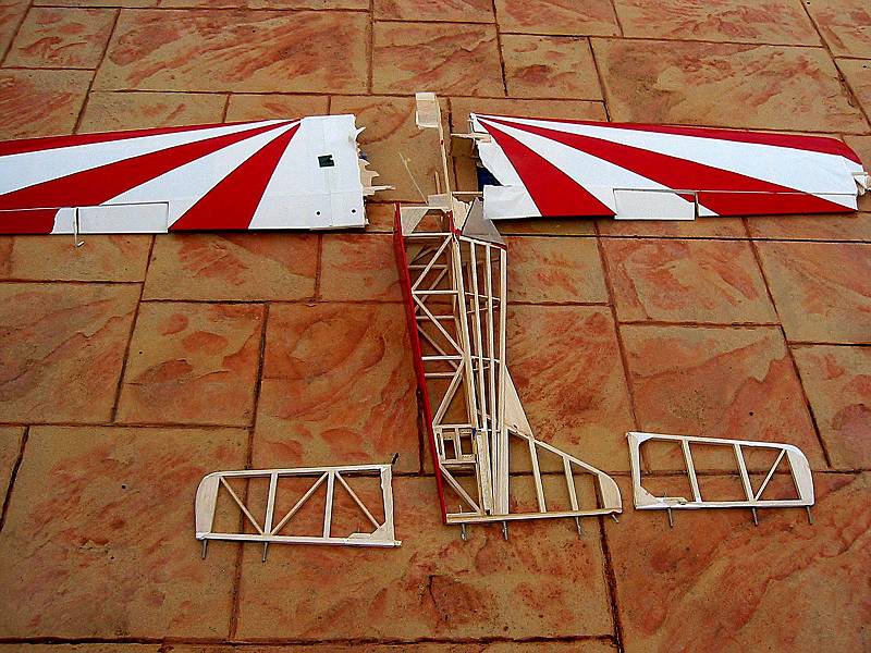

Just to stir things along, I have used Sig Bond for this application almost exclusively for the past eight years. The wreckage pictured here was an 80" span 90FSR powered sport aerobatic machine shot down after approx 5 years of energetic working out.
As an exercise I dug out most of the hinges from here, cleaned them up and reused them in its similar design replacement. That one still gets regular workouts. Last flown about two weeks ago, it is showing no signs of any failure.
During installation I feed a small drop of sewing machine oil into the hinge itself and install both halves at the one time. I then clean any excess off the area with a cotton bud dipped in plain water. This method has never let me down...

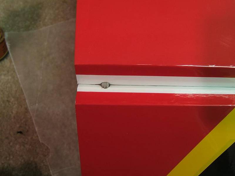

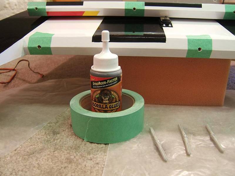

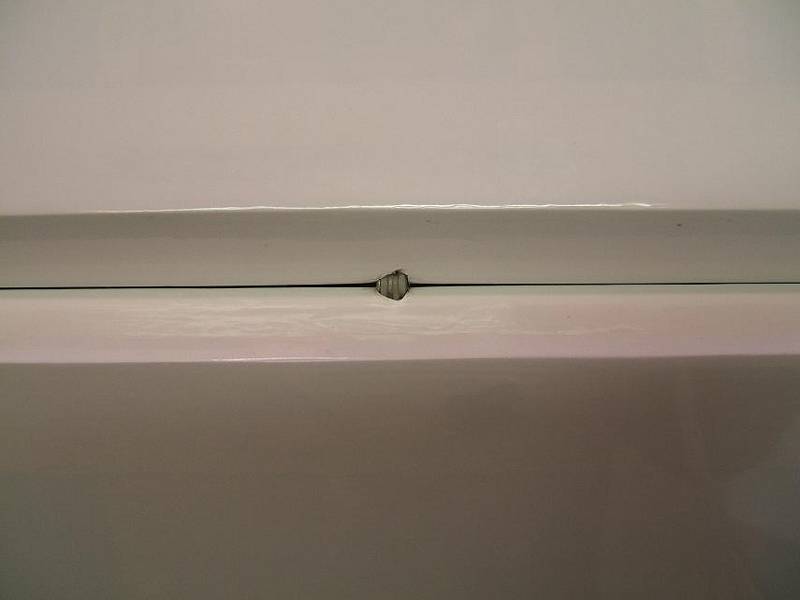

Here's some pictures of the process. Squirt a little bit of glue into the hole before you put any on the hinge, then slide it in and use a small piece of dry paper towel to catch the top and bottom excess. Of course the hinge joint has Vaseline on it to prevent the glue from entering the joint. Final clean up will come about an hour or a little more after joining the parts. I'll post some more pics when that comes around. Notice there's no mixing cup anywhere? Straight out of the bottle.

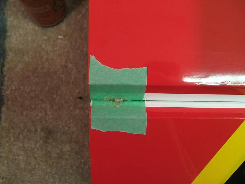

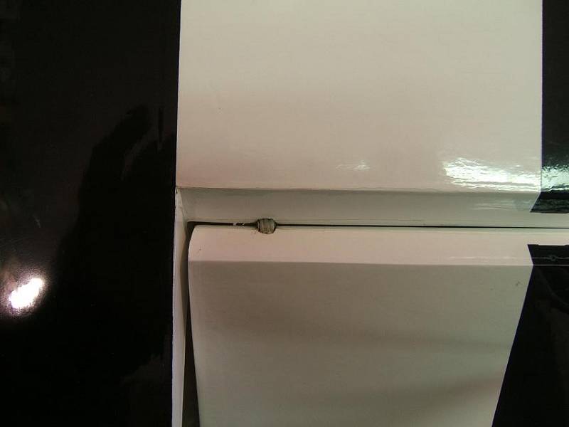

Gorilla Glue, finished product
If you follow the directions on the bottle you'll note where it mentions moistening the surface to be glued. The humidity where I live is always above 10%, which is the low number on the instructions, so I've never bothered to moisten anything. In doing this hinge job it's been raining for weeks so there's plenty of moisture in the air and wood to set things off. If I was to use water to add moisture the expansion would be even greater and it wasn't needed here. Where you are and what you are glueing will determine what you need to do regarding additional moisture.
In the following pictures I started with two pictures of the side that was on "top", then rolled the wing over to the bottom where liquids naturally migrate to so you could see the expansion and residual mess. Use a paper towel wet with acetone to wipe down the top of the hinge, removing the excess glue. Use one paper towel for each side of the wing to avoid carrying adhesive from one side to the other. Next I used a sharp #11 Exacto blade to cut the tape at the hinge line. Best way to do that is to lift the tape, roll it back towards the hinge line, and lightly cut it from the adhesive side to avoid cutting the covering or balsa hinge line. Do this on one side of the wing then roll the wing over and pull the remaining tape.
The finished product after removing the tape is in the final pictures. There was no additional clean up after removing the tape.

Addendum to clean up:
Just to try something different, on the next plane where I used Gorilla Glue I wanted to see if the installation could be done without wiping excess off after it expanded. On every hinge surface I used the same procedures but omitted wiping off the expanded excess with acetone. I just left it there to dry completely. The results were that there is no need to wipe off expanded excess at any time. Just lifting the tape from the surface and cutting it along the hinge line provides a clean removal. The tape takes the excess away with it, saving the effort of the wipe down and eliminating any chemical use.
You still need to wipe away any drippage that occurs when you first squirt glue in the hole and insert the hinge but after that just leave it alone until it's dry. If you apply Vaseline to the hinge knuckle prior to installing the hinge in the hole the glue cannot stick to the exposed knuckle as it expands out of the hole.
