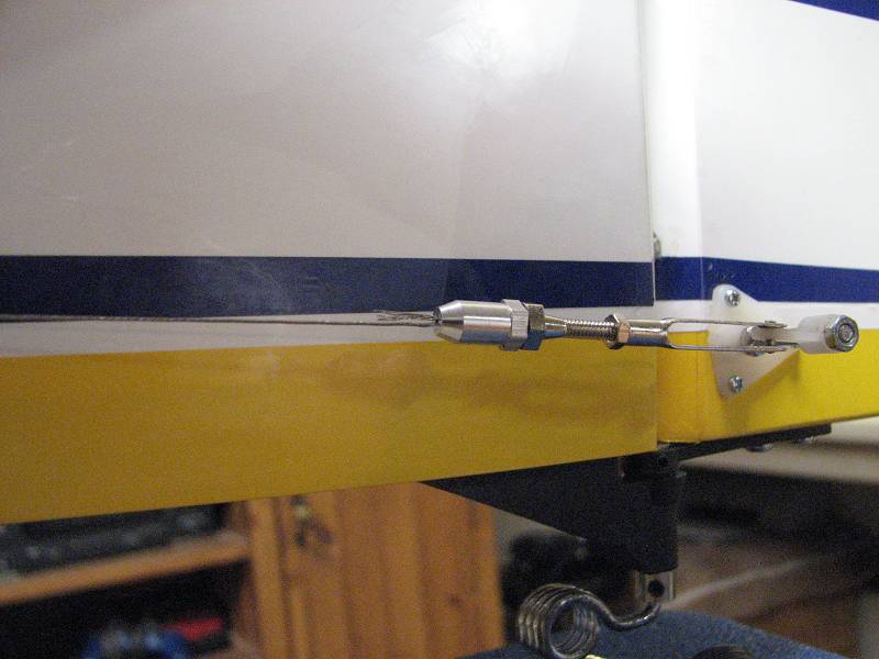

Here's a pic of the great planes pull-pull installed (minus the fuel tubing to hold the clevis on)

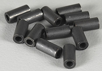

I used to cut small lengths of brass tubing to use as crimps ..... (what a pain in the $%@# that was) ... until I learned that these were available (from DuBro, in 2 sizes). $ 2.50 for a bag of 12 ... (money well spent). Bob

I see some sharp looking frayed ends sticking out of the wedge clamp that could make you bleed.
How about some heat shrink tubing over it?
Harley Condra
BVM REP
JetCat REP

Harley,
This was before the plane was finished and the picture was taken for my build thread. Since then, the clevis has gotten fuel tubing and the wire has been cut evenly with the lock.
Austin

Good move. Punctures are painful.
