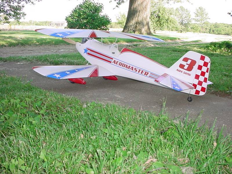

Tower Hobbies sells a couple different decal film sets. I used the laser decal film set with good success on my new Aeromaster. Just the word Aeromaster and the fin numbers. Paint is Rust-Oleum. I sprayed clear Rust-Oleum over decals to fuel proof them. Rust-Oleum must cure at least 2 weeks before exposing to fuel.

I started painting the Aeromaster with Rust-Oleum before I read posts by some people who said it is not fuel proof. So I tested with raw 5% nitro fuel and saw no problem. I did let it cure for about 4 weeks before testing. I have flown the Aeromaster 3 times now (3 different days) and so far there is no effect on the rust-oleum paint. I did clean it well after each flight. About the only place the exhust gets on the model is on the right stab. Also I get raw fuel in the engine compartment because of the inverted 4 stroke carb.
I will post here after a few weeks of flying to let you know if the rust-oleum is holding up. I don't know if you can spray clear rust-oleum over dope or not.
