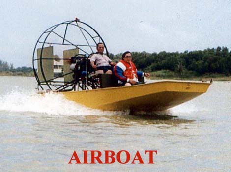

I asked my friend for more presicion describing the thing: It's a flat bottom boat powered by a air engine, the tipycal we use for planes. I undertand clearly the water often can go to the motor... We all know what happens when a Lipo goes on short circuit...

Something like this? Should be easy enough to create a waterproof hatch and put a "cone" type device in front of the motor to deflect water.
Mike

OK Mike; you're rigth but, What if the boat turns upside down and the motor goes in inmersion? I coud recieve a short circuit, isn't it?

Use brushless and put all the electric in a water proof compartment like the boat guys do.

Ghost is absolutely correct. The brushless motors aren't hurt by water entry, there are no uninsulated or switching connections in them. Keep the rest of the electronics safe, and the motor will be fine. RTV sealant makes great re-useable form fitted silicone gaskets for hatches, and vasoline on those seals will keep water out really good. Clear tape does well for smaller penetrations.
Be sure there's a way to cool the ESC. Most larger boats use water cooled ESC's.
