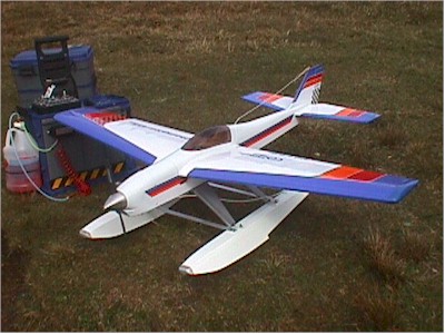

Greg...for easy to build and VERY durable floats, try the Great Planes series. For the 40 sized plane, buy the 20 sized floats. You'll just have to trust me on this one. It works the same way all through the GP Float series. The 40 sized GP floats work terrific on the Tower Trainer 60 and other 60 sized planes....the GP 60 series float will work on a plane up to 15 pounds! (120 + Sized) I'll try and attach a pic of the GP 40's on a 60 sized trainer and also the GP 20's on a 40 sized pattern ship. Tracy

Old 03-22-2002 | 12:23 AM
Posts: 92
From: Ketchikan, AK,
Default Here's the other plane
40 Sized airplane...on Great Planes 20 Sized Floats. Covered lovingly in Monocote. TM
