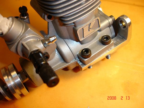

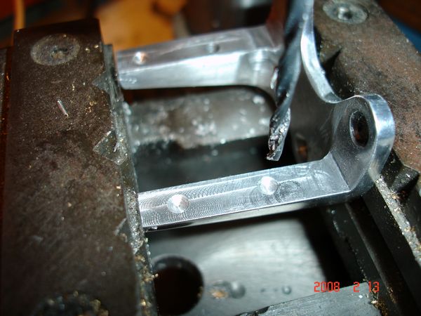

Old 10-21-2009 | 10:57 AM
Posts: 7,816
Received 10 Likes on 10 Posts
From: Upplands Vasby, SWEDEN
Default RE: Looking for Non Tapering Engine Mount
Hi!
Nut and bolt??
Why!
Much easier to tap the mount and not bother with a nut that is hard to reach ...
This is how it's done.
A to B...

Old 10-21-2009 | 12:23 PM
SeamusG's Avatar
Joined: Jun 2007
Posts: 3,919
From: Arvada, CO
Jan - A big thumbs up! No matter how often I try it's never that easy.
I believe the key is to have a drill bit of appropriate size (for the tap) and long enough to allow you to keep the hole vertical & square to the mount.
