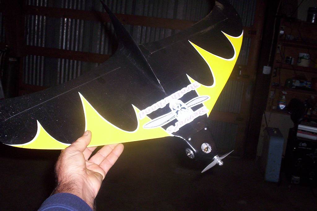

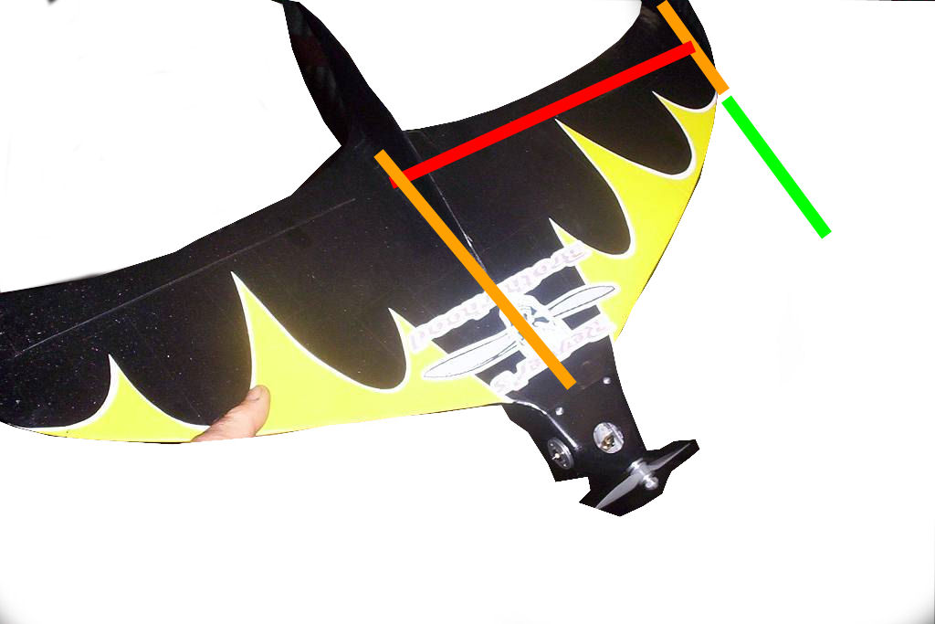

The ball park idea works like gangbusters in Geistware.
To retrieve valid dimensions off a chalk outline would take you how long?
I'd bet with your experience, you'd have measured that wing the with the same estimations done in the attached picture. The attached is how that wing would be measured for Geistware. It took me longer to draw the picture than it'd taken me to measure the same way shown with a yardstick.
The orange lines are the root chord and tip chord. Yup, they're estimates. The red is the half-span and the green is the sweep. And yes, the sweep has to be done "in the air". Good of you to mention T-squares. The sweep measurement is more accurate if you have some reference line to work with. Figuring a means to do that accurately takes no less effort than working up lines to draw on paper, wouldn't you say? Of course, if someone is about to suggest that often the lines are already drawn on the plans................ measuring the plans is easier than blinking your eyes.

So you crush the prototype model flat on the floor to get accurate lines on the garage floor? We both know you don't.
So how do you get accurate measurements of your "not on paper yet" model? Same way anyone would work out the measurements for anything, and that works just as good for the application.
A lot of what I build is design as you go and never gets formally drawn up until the design has proven itself.
The simple method requires a root chord, tip chord, LE sweep and half span. Same with geistware. What about the simple method makes it easier for you to come up with those? How does the use of a measurement make it more or less accurately taken beforehand?
I've done what you show, but if any slight error in judgement is used for interpretting the shape, Geistware will still GIGO you an unworkable CG. The CG range of this .061 powered plane is the thickness of my pinkies.
