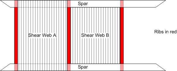

Style A is more structurally sound.

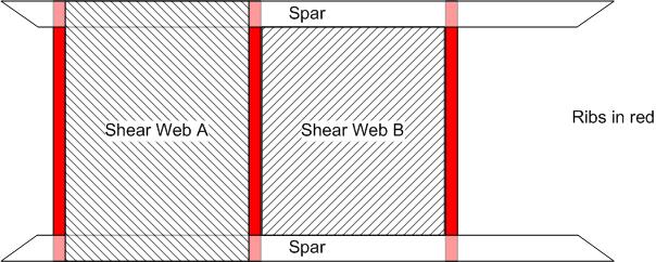

If 45 degrees is the best then get the best of both by installing shear webs on both the front and back sides of the spars. Upside is strength. Downside is weight.

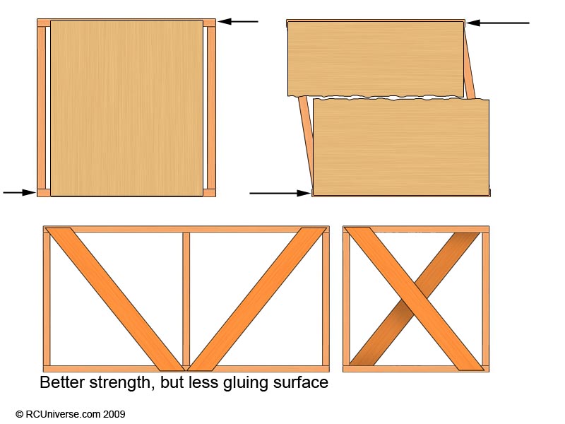

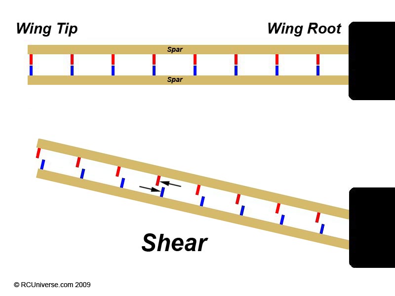

What you need to understand is that we are talking about SHEAR.
"Shear" is when two objects (in this case, the spars) move in opposite directions to each other.
As air pressure lifts the wing, and since the weight of the fuselage is at the root, the wing tries to lift at the tips. This causes the spars to try to move in a shearing motion. (First image)
Although the pressure is at 45 degrees, the movement of the spars is relatively 180 degrees from each other. So a horizontal grain is more likely to split than a vertical grain.
You COULD add strips at 45 degree angles, but this will result in less gluing area. Of course, you could also cut full webs with a 45 degree grain, but for the most part, this is overkill.
The bottom line here is: I have built MANY planes with a vertical grain web and have absolutely tortured them without a single wing failure.

Your point is well illustrated. Shear web is for shear pressure.

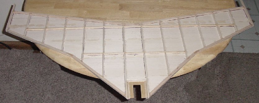

Guys, The main problem Mike is having is a bit different than you think.
This is literally a flat plate wing only 3/8 of an inch thick with a 42 inch overall span.
He is asking about grain orientation as it applies to what is essentially a stress skin wing.
If the wing were thick enough so as to be able to use a shear web the 45 deg setup is thought as what is being optional.
But were Mikes wing is so thin he is trying to come up with ways to use the sheathing both to stiffen the wing, and increase the torsional strength, because as it is now flutter is a major issue in his design.
So bending the wood to the airfoil shape is not an issue, coming up with a way to get the most strength both span wise and resisting twisting is.
His spars and alike are limited to 1/4 inch in height so that is all he has to work with, and he is trying to do it in wood as opposed to using exotic materials.

ORIGINAL: MinnFlyer
If that is the case, I would sheet the wing this way
Here is what the wing looks like it a bit unconventional, as it is a hybrid delta flying wing...

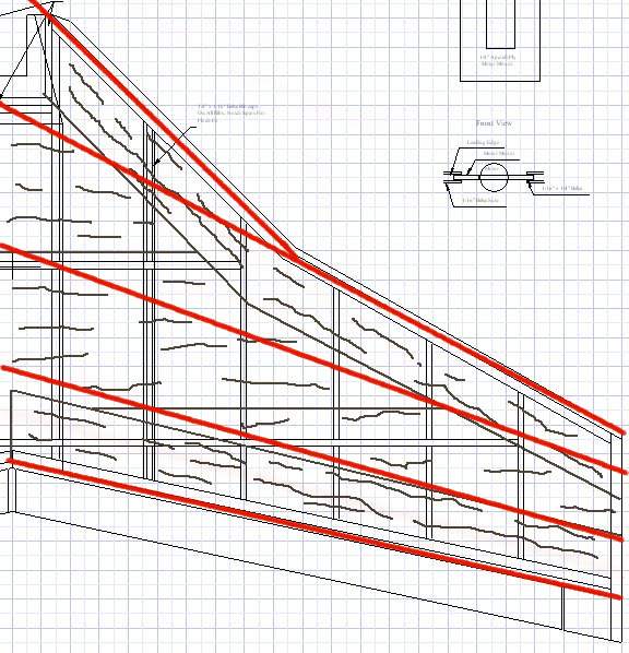

Mike Connor's Avatar
Posts: 2,025
From: Tulsa, OK
Default RE: Balsa grain direction
I prefer all grain run parallel to the spars unless there is a strength advantage to following the leading and trailing edge. One option is whats in black on the attached pic and someone else suggested what is in red. Your suggestion is doable but a lot of work on a multi taper wing.
