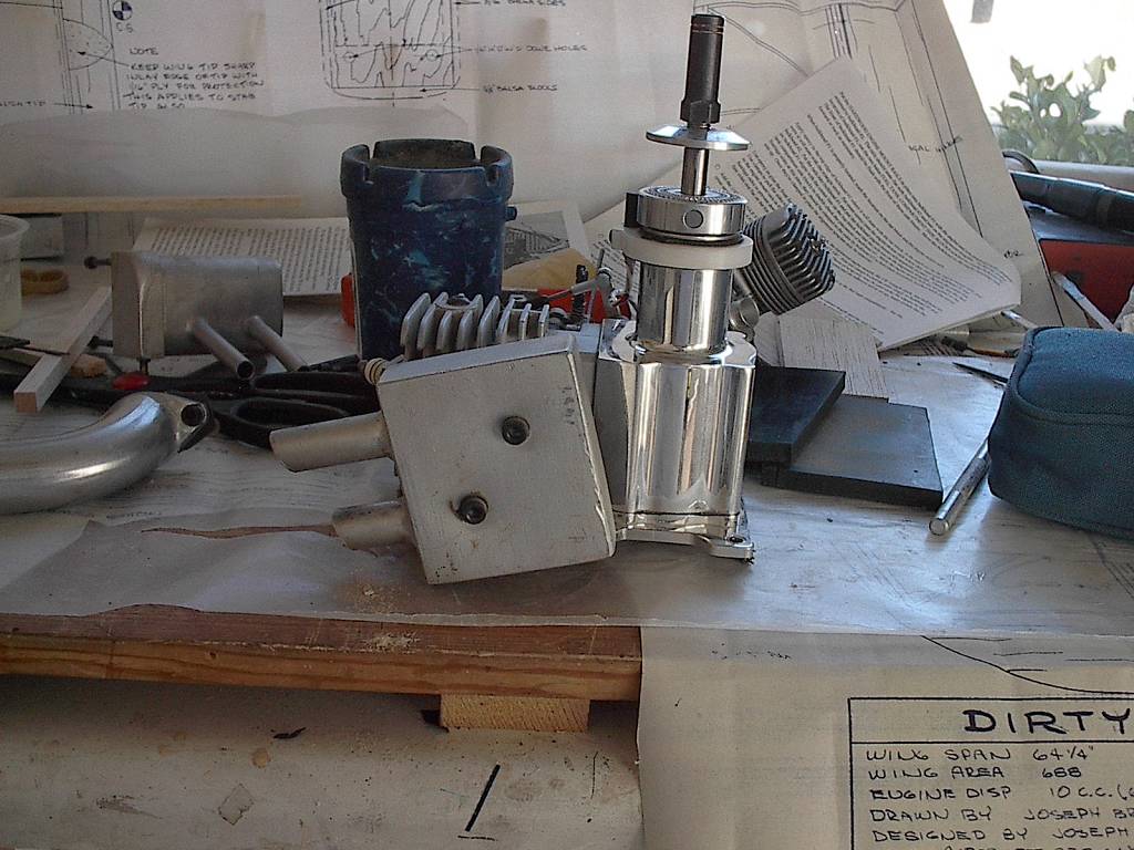

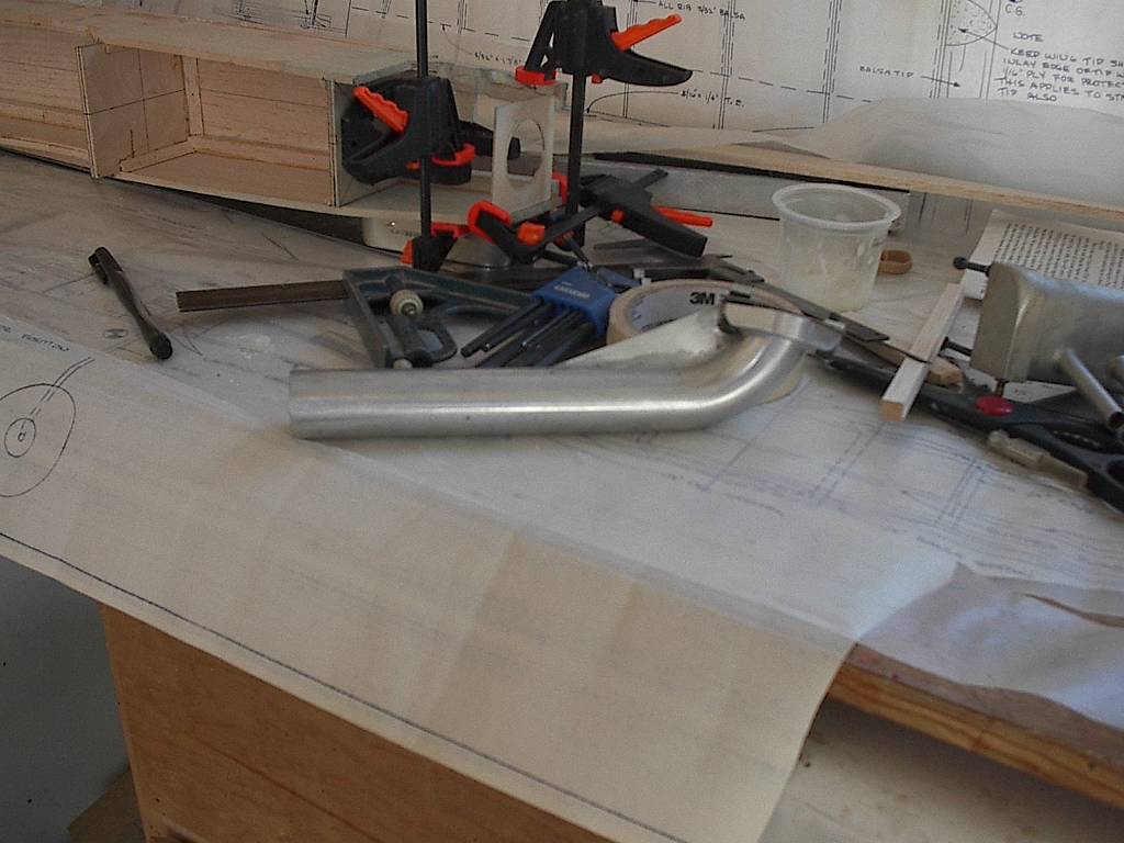

Two different types, a side exit exhaust and a header/racing pipe we used to make up for the Madera Racers.
