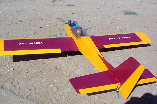

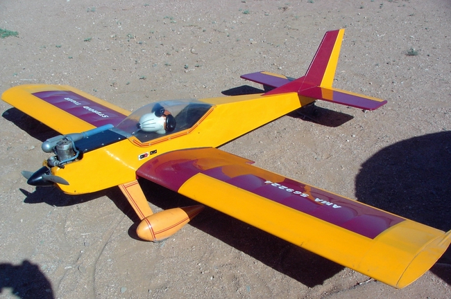

JohnBuckner's Avatar
Posts: 10,441
Received 11 Likes on 11 Posts
From: Kingman, AZ
Default RE: Standard servos
As Gray Beard and Minn flyer has already pointed out for your use those servos are perfectly fine and you will never know the differance. Running five cell packs is a good idea though and I no longer do any setups with four cell packs especially if you are using 2.4.
I still have a number of aircraft in that size and weight catagory that have served long an well with no special servos.
The whole world does not revolve around 3D
Here is my old Tiger I built Ah fifteen years ago or so blown up to eighty inchs and fourteen pounds Still has the same old whatever standards and I gave away a year ago and the gentleman is flying it constantly just fine.
John
