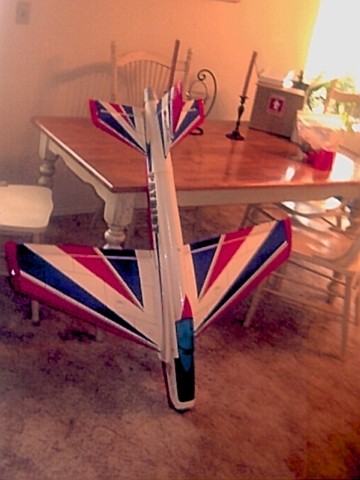

I know this is an old thread but.. I am putting an Irvine 53 w/pipe in mine.. I did a poll here recently, and the YS-45 was the big favorite, I think a Rossi 45 would be a good fit also.
james
