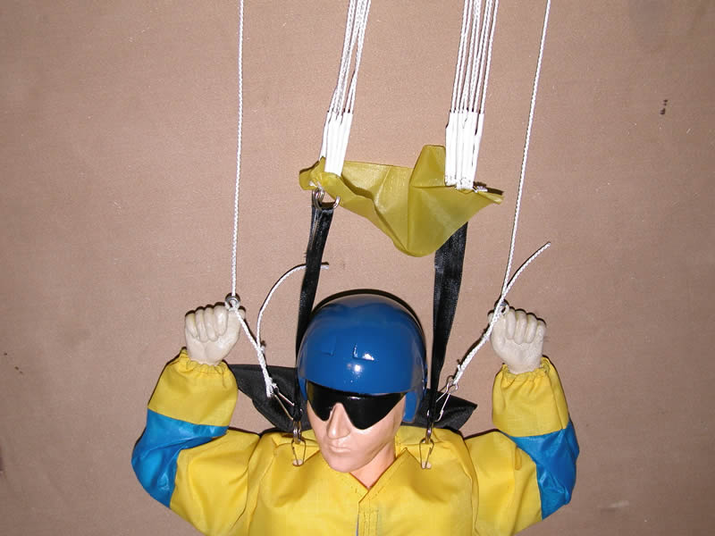

Here come the details...
A view showing the backpack:

Default RE: rcskydiving.com Beginner Jumper
The non-functional slider and the clean rigging; the jumper head is pretty cool as well:

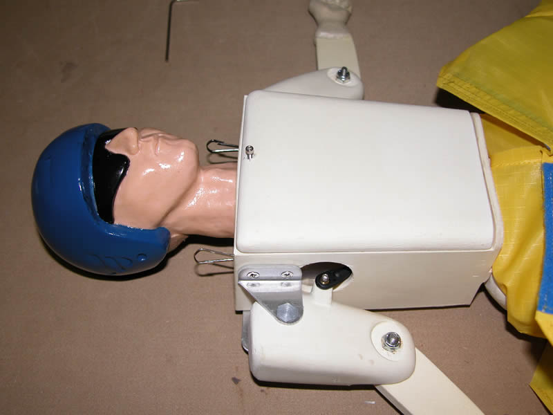

Suit removed to reveal chest:
Chest opened; the arm pushrods come already installed and include all the necessary hardware; you just provide the servos. Pleas note the basswood sticks and music wire are packaged inside the chest.

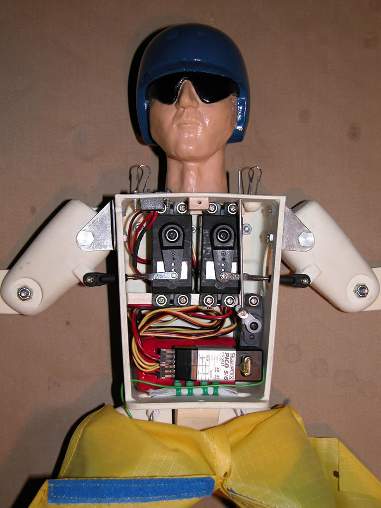

Now to some questions. Here it is my final radio setup. I followed instructions and installed:
2 HS-77 + heavy duty arms (borrowed from HS-645MGs)
1 HS-81
1 4.8V, 1100 mAh battery back
1 normal-range receiver that fits
1 Hitec micro switch harness
First 2 pictures show everything above.

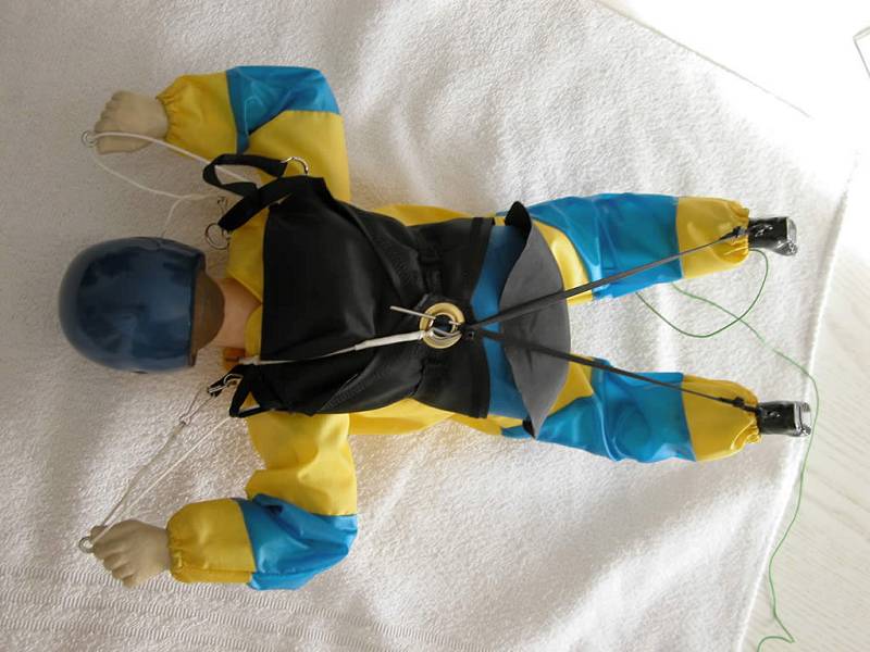

Question #1
Arms fully up: elbows should contact the body (upper travel end), this way 'chute opening shock won't -pull- on servos possibly damaging them. I'm I correct? First pic on the left.
Question #2
Arms fully down: travel must be reduced so that servo arms won't interfere if both jumper arms are pulled down simultaneously. Referring to 2nd picture from the left, right servo arm should not travel more than the green line.
Last picture shows real question; once servo travel is adjusted so servo arms don't interfere, jumper arms lower that much: is it enough? Should I shorten the clevis some more (yellow circle)?
Question #3

To anser your questions.
arms fully up should contact the main body.
You have plenty of movement in the arms, you are right ,you don't want the servos to hit each other. this much arm mpovement will make him spin very fast one way or the other on descent.
The release pin should stick out of the body the maximum amount you can get and still have it retract just below the surface of the main body. How far it sticks out isn't that critical, you just want it to fully retract.
And to answer Porsche968 question, we drop them from a radio controlled plane.
