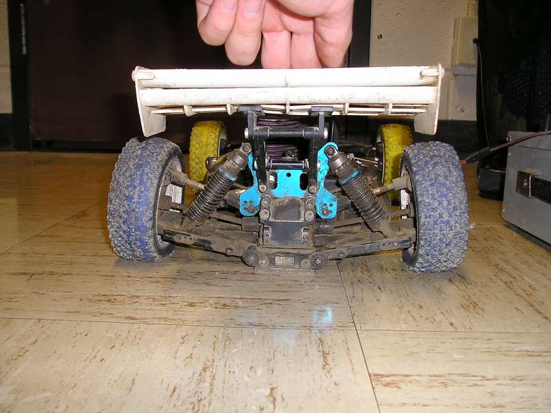

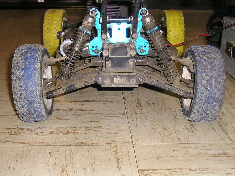

Hi everyone.
I am new at this and I noticed that one of my back tires is all messed up, but other one still fine.
Here are pictures.
What should I do to fix it?

Is that buggy sitting on something in that picture or do you have the ride height set that high????
Looks like the fronts are warn bald too,
Recomendations??
First have the buggy set closer to a-arms level and have no more that negitive 1-2deg camber
I'd raise the camber link to the upper inside hole on the shock tower too, that will take out a lot of the camber change through the arm travel
Second, if you're not racing get some stiffer compound tires
Those ofna "colorz" X patterns are crappy tires anyways
If you're running in hard pack try Knuckles or if you're just bashing the "Badlands" are very good too

wow so much ride height. i think you need to add some thicker or refill your shocks

No, I was holding the buggy up thats why it looks like its too high.
Tomorrow I will try to play with the adjustments.
Thanks for the advice guys.

What kind of surface are you running on?
I'd like to see a picture of the car sitting on its own
Also, Have you ever done the Diffs? or do they still have the stock grease?
Some fresh oil in there probably can't hurt

u should also look into why 2 of your tires have turned yellow

I made some adjustments but that did not help. I found out that that rear shock does not have oil in it, which caused the tire bounce.
Thanks for the advise though
