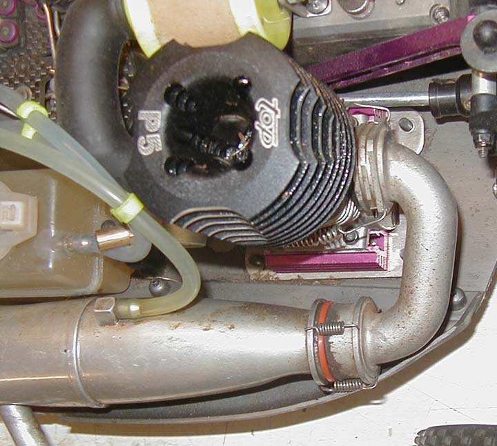

I just got today an 086 ofna pipe but i noticed when i try to put it in my PBS that the manifold is a bit short in order to place the pipe as the black stock one was plus the 086 is a bit thick and therefore touches the fuel tank.Also i can't place the body shell.Do i need a new longer manifold?

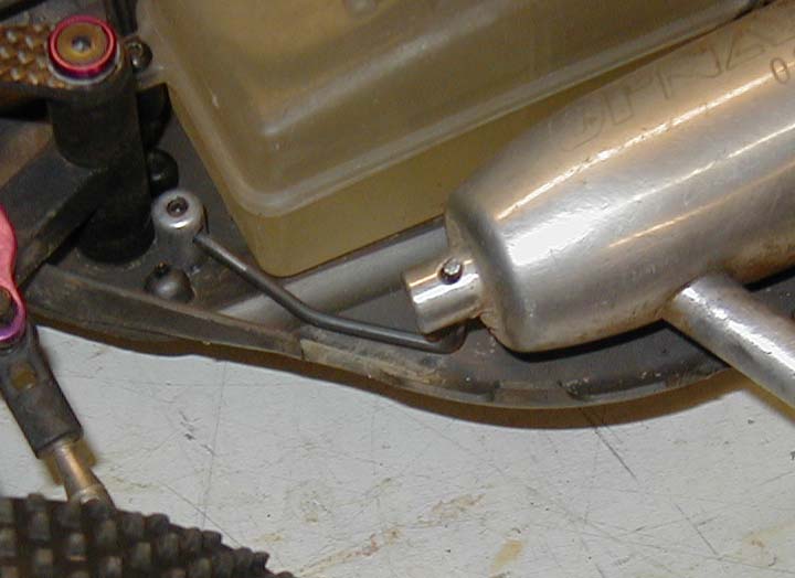

No you can get it to fit the way it is,,you will need to bend and re-adjust the pipe suport wire a little,,,also if needed you can flare open the header a little to alter the angle of the pipe so it fits square with the header,,I had to do that a little too
look here,,,same pipe

Am not sure how to flare open the header.Am concerned that I might destroy the header if i try to alter its angle.

It's very soft aluminum,,I've had to do it at the track after getting t-boned
just get it warm, not red hot just warm and take a couple large screw drivers and pry it open a little, it doesn't take much,you'll be amased how easy it is

Am trying to get warm the manifold in order to alter the angle of the pipe so it will fit square with the header.It's an ofna pipe for an ofna car why I have to go through this ****?[:@].Btw my manifold doesn't seem to have the flange you've mentioned.

lolol...am a bit reserved on throw it on the oven although I may try it right now.I tried bend it without warm it but i didn't manage to succeed.

OK victorious. i got pissed and tried to use more power without warming it.I let my fear of destroying it away.Now its fine[8D].Fortune favours the brave[&:].
