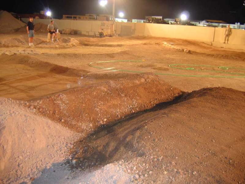

Hi all.
I been having trouble with my OFNA buggy bottoming out on our track out here in Kuwait. Attached is a picture of the bigger jump on the track which I have the most trouble with. I have big "spacers" on the shocks and was wondering if I should put more? Will it make any diffrence since it sits so low to the ground anyways. Also, if I do add more, I fear that I'm going to almost defeat the purpose of the shocks and end up bending them or something.
Anyways, thanks in advance for any help.
Chris
Chris

What OFNA shocks? fluid? springs? Try heavier shock fluid for starters, maybe stiffer springs if the problem persists. Remember...its ok for the suspension to bottom off the big hits, if it doesnt bottom out your not using all your suspension travel.
The preload spacers are used to set ride height... they do not increase the spring rate.

Stiffer springs don't help much when it comes to bottoming out, setting the spring tension mostly raises or lowers the ride height.
Here is what you can do keep from bottoming out:
-Thicker shock oil
-More Droop (move your shocks to the lower holes in your shock towers, this will give some buggies more droop if their shocks were the limiting factor)
-Use shock pistons with smaller holes.
A combination of the above should fix your problem.
-Thicker shock oil

the only prob w/ that is it changes each one diff so they wont be consistant and the same. as for the other Q: the white springs are the stiffest and work well. you can change the shock position so its as straight up and down as you can get it. i run 50wt in front and 35 in the rear & 1.5 2 hole pistons on almost all the tracks i run at. like stated you are going to bottom out , dont set it too stiff cause you will have trouble on the rest of the track. it will be unstable and want to roll on its lid all the time. on that big jump try to tap your brake so you land on the front wheels a little before the rear ones so you dont get that "smack" in the rear.

Move the shocks all the way to the last hole on the lower a-arms. Then use the hole on the shock tower wich stands them as straight up as possible! Use thick shock oil and a stiffer spring. But like the rest have said you are going to bottom out, the best thing to do is get throttle control and get to where you can land the jumps on the down ramps. Not only does this save your chassie but it will make you faster. Slow down your approach to the jumps if you are overshooting them.

If you are bottoming out you need to increase the "pack" that your shocks provide...
Pack is created by turbulence in the shock absorber fluid, so to keep your damping similar to what you have now the correct way to increase pack is to use pistons with smaller holes and thinner shock oil...
Merely changing to thicker shock oil will make the buggy nasty on bumpy sections... try 1-1.2mm holes in the pistons and 30 front 25 rear shock oil...

There is one other thing you can do, that is to add bump stops to the shocks...
A small piece of fuel tube on each shock shaft (5mm long) will act as a bump stop for the shock...
Hoever this will restrict the overall shock travel in some instances
