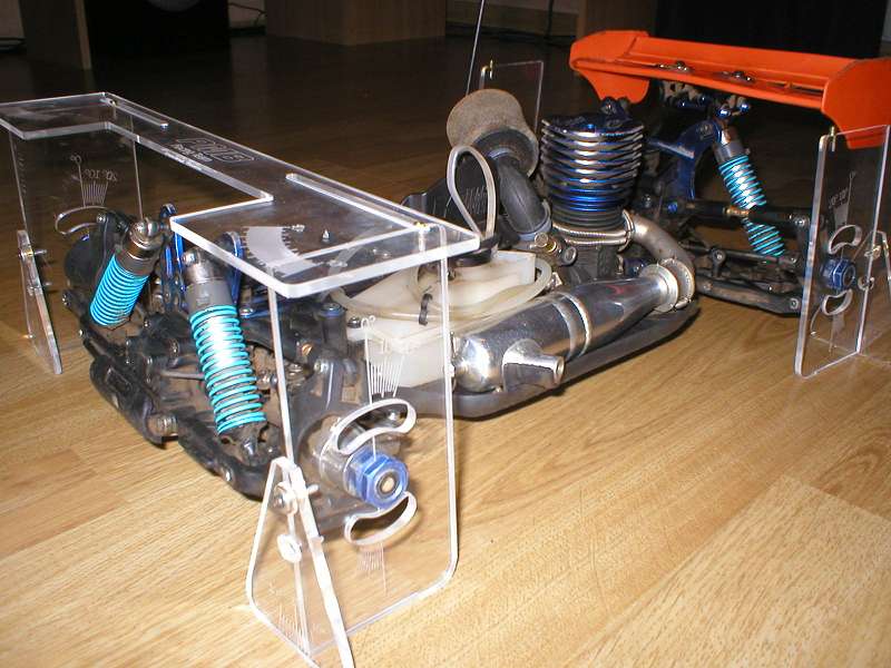

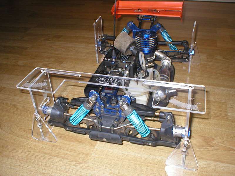

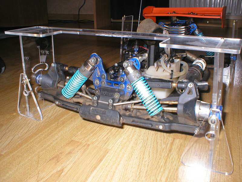

Hi again everyone its been a long time since i started a thread here mainly cus i have been busy with school (and of course RC) [8D]
So the season started a few weeks ago and everything has went fine, im on the hunt for the perfect setup right now so i decided to get a setup system.
I asked at the LHS what the Hudy system would cost me and man it was expensive [X(]
So i spoke to my friend JJsson and a few moments later we had 2 PMB setup systems on order.
It took them about 3 days to get here (from somewhere in hong Kong i believe) and i met Jont to get mine today.
Back home i instantly started to put it together, it went together nicely and i did a few settings.
Its one nice setup system and about 3 times cheaper than the Hudy one!!
So well see how the buggy does at the track next time.
Regards to JJsson who was kind enough to order one for me cya at the track m8!
Here are some pics of the system with the car in it. Ow and it came in a nice textile package kudos to PMB for an excellent product!
And YEA i havent missed all the dirt which is attached as glue to my car [:-]
