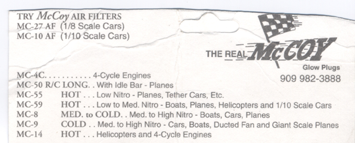

I am running 30% nitro in my S7II with a Mckoys MC-59 plug. Can someone clear up wether its a hot plug to use with a high nitro content or is it the other way round. I have read a couple of threads about this but both said the opposite high% nitro = hot plug then the other thread said high% nitro = cold plug? What are the effects of changing plugs?

Typically,
High nitro = cold plug
low nitro = hot plug
the mc-59 is med to hot,
I use that plug with 20% nitro in my .12 engines
I think it will fire early with 30% in that engne

Thanks for that, I might have to change the plug by the sounds of it then, although it is a modded engine. Im thinking of going down to an RB 6 plug?
