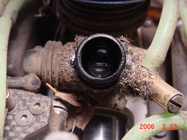

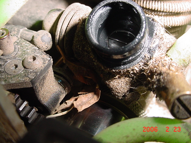

Does this look like a bad seal around the carb? I have never had an engine with this much gunk around the base of the carb before and my engine idles too fast no matter what I do. It's a Novarossi 528XR and it has almost two quarts through it. I thought maybe some of you experts could tell by looking. The temps are fine and it runs great it just won't idle slower no matter what LSN setting I try.

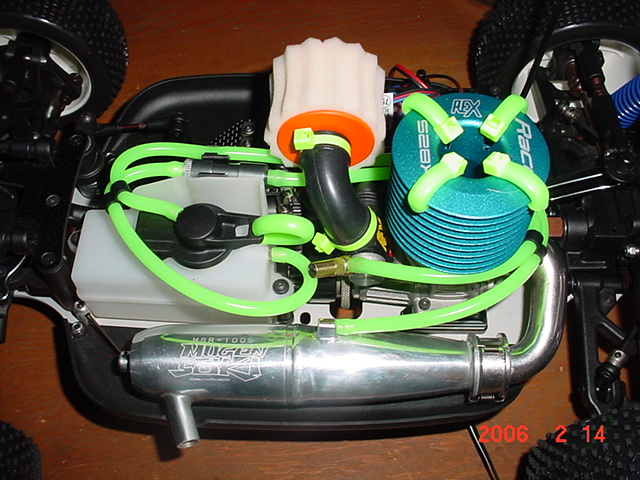

This is what it looked like before today, the buildup is from four or five tanks of nitro. But thanks for nothing.

You asked whether or not you have a bad seal, I answered and it was yes, your seal looks very much destroyed, judging by the buildup, unless that buildup took a long time to get there, in which case it is your wash habits, not your seal at fault. So you are welcome for nothing.
In the case of your idle, did you try your idle screw too, or just your LSN to change the idle? If not, I would start there.

This is a strange one
the only way a leak could be there is if the engine is backfiring and spitting fuel back through the carb and out of the connecting tube.
is there any fuel on the air cleaner?

The leak is before the fuel and air mix so the problem is the idle. The seal is only the attachment of the cleaner to the carb. I belive a rich mix compensated by a high idle to keep it running is spitting a little fuel back through the carb every once in a while, gravity pulls the fuel down throu the gap in the seal it will not cause any mixture change as it is before the fuel and air mixes.
If fuel is escaping then it is possible dust may get into the engine after the filter so make sure the air cleaner is strapped down air tight

mabey seal up the hsn that looks like where the heaviest buildup is.

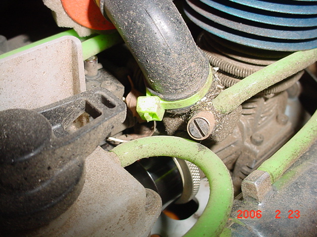

I think you may be right but i dont think this is the main reason. The fuel pipe does look a little too wide for the nipple, check it to see if the pipe is still fully flexible at the end check that the everything is fully tightened (fuel nipple).
Everything should realy be checked after each use as they do take a good hammering and the single cylinder engine bouncing up and down anything up to 500 times per SECOND causes even the tightest threads to come loose.

If your idle is too high and too rich you will get some fuel pushed back through the carb. That is what it looks like is happening here. It looks like this is only a two needle adjustment on the carb and does not have a mid speed valve. The screw you see in the middle of the carb just below the intake is the idle adjustment screw. Just turn this counterclockwise about 1/8 of a turn and your idle speed should drop, then adjust your low speed needle on the end clockwise if you need to lean it out a bit.
