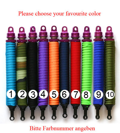

Hi I have seen some of those shock covers which go over the spring etc on some peoples pics and on e bay. Do people think they work for keeping out dirt etc.... and are they worth purchasing. As I live in muddy england they might come in handy on those wet/damp days thx in advance.

Shock socks rock!
They work. They're cheap. There's no reason not to use them.

Hahaha I guess you have them lol, they seem like a good ides protect you vital buggy parts. Cheap well what am I waiting for I need to buy some, anyone else have there opinions???

had them, used them, didn't like them. don't get me wrong everyone is entitled to there own opinion, but when i used them all they did wass lock whatever dirt got inside. after a race when i would go through my buggy for a good cleaning i would take the shock socks off and sirt and grime was all up in my shock. just throwing out my experience.

those sock shock do cause a bit of resistance, so i try and stay away from them. The best idea ive even seen is that on the jammin x-cr shocks. They dont cause any type of resistance, and do a great job keeping dirt from getting inside the shcosk, and scrathing up stuff. also the little rubbery plastic boots that the hyper 7 ( and i think hyper 8) shock come with work well, but they do eventually tear.

Yea my hyper 8 came withe the silicone seal/covers but they just seem to rip and i thought the socks would be more durable and keep more dirt out???

If you can get the right ones for your car I would say by all means use them. They can only help. I also dont really like them but I am going to have to use them unless I want to keep spending $40-50 to rebuild my shocks every gallon.

I got one of those silky book covers from wal-mart(meant for text books). Cost me $.79 and I had mamadukes sew them up
http://www.rcpics.net/media/082703_01.jpg
http://www.rcpics.net/media/082703_02.jpg
http://www.rcpics.net/media/008_body_off.jpg
Give it a shot. If you don't like them then oh well you wasted $1 and some time.
I don't have that truck anymore, and I have a Hyper 8 now(I've seen the light) but I personally didn't have any real benefits from them... fine dust still gets through, but it did keep thick mud and whatnot off. I use the rubber ofna booties now.
