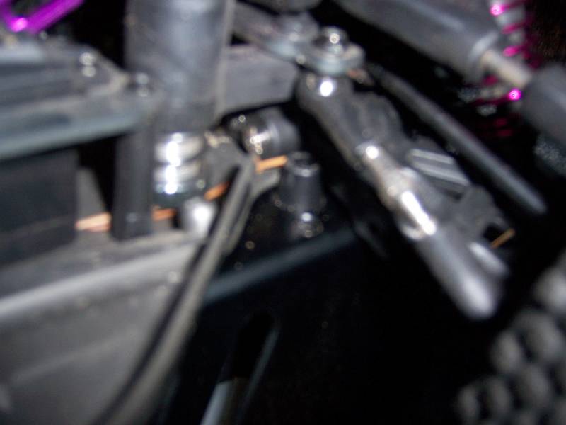

I have that same started box for my hyper 7, I had to take that front plate off since it holds the chassis of the buggy up to high, then I drilled holes in the strter box to mount the 2 post flush on the box so that they sit right up in the corner against the chassis and a-arms. I did have to lower the back like you said,but still wast enough untill I removed that front plate. Works great now. Here are some pics that might help make sense of what I said.
I took pics of the front 2 post and showed where they fit up against the buggy on both sides up front. Also took a pic of where I have the back post fitting into the rear a-arms. Hope this helps.
It didnt seem like it had enought power to turn over the used motor I had until I did this,now it turns it over with ease, turned over my new nova rossi with no problems during break in with two 7.2v batteries.

thanks reb 2973
removing the front stand on starter box help start the engine . the pictures were a little fizzy, can you resend them
Yeah i cant figure out how to make the camera take close ups very clear. It was just to show where I mounted the front post to hold the buggy secure in the front.

Thanks for letting us know it's going no.
Reb, you need to learn how to use MACRO and hold the camera dead still.
