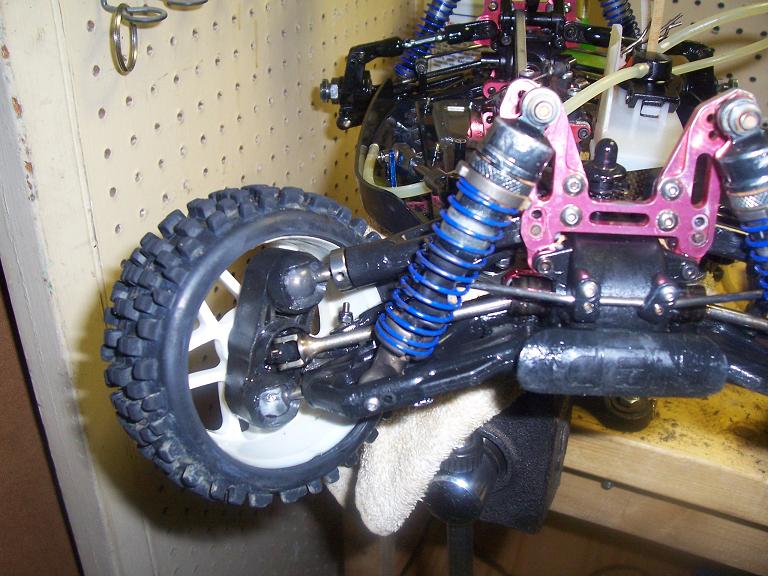

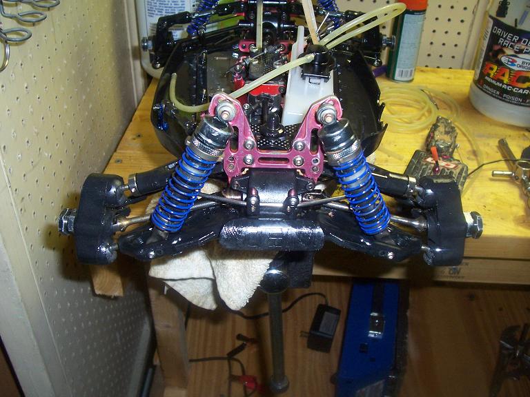

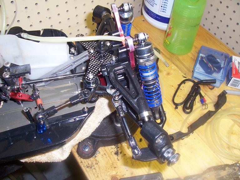

yes and no, with more steering throw you will turn noticeably more and even too much. you'll have to turn down your dual rates at times. i had a lot of people tell me to get rid of the pbs in my hyper 7 till they saw it after i modded it then they said they never saw pbs turn that much. the first step to improving turning is tires, make sure you have the right tires to do the job. hole shots turn better than bowties.
if you do decide to mod the knuckles its not hard to do. the hole where the ball goes in will be widened to the front and back, ****not up or down****, so the wheels can physically turn 5-10 degrees more at full servo throw. another thing that helps that is to drill another hole in the knuckle arm about 4mm closer to the ball, then cut off the excess in a straight line parallel to the lower arm at full throw. it sounds complicated typing it out but it is very simple. i used a dremel and carbide drywall bit to do the job. i now have the hyper 7 pbs front end in my cen matrix and it turns inside c-hub cars.
