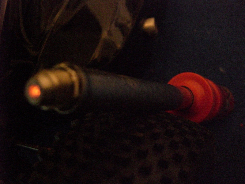

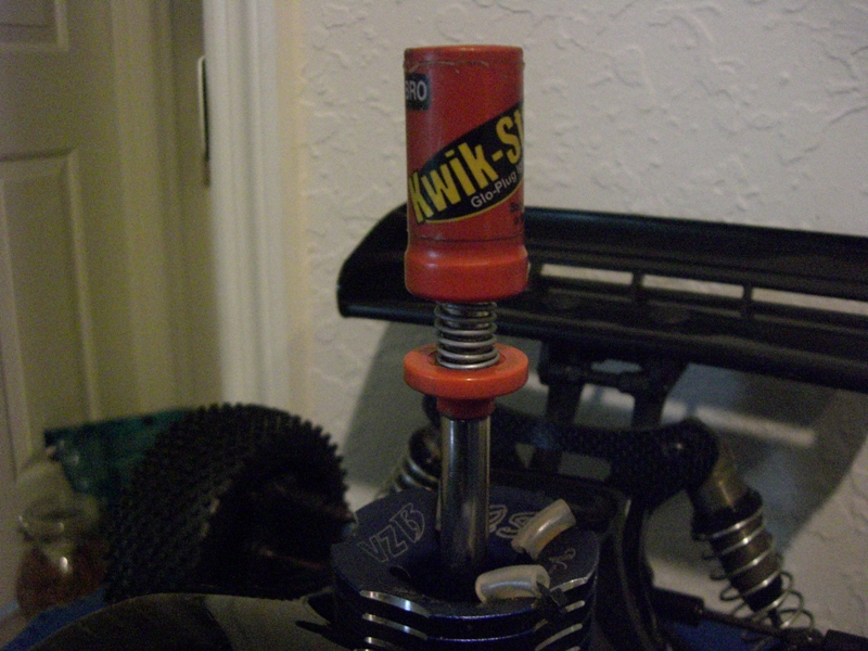

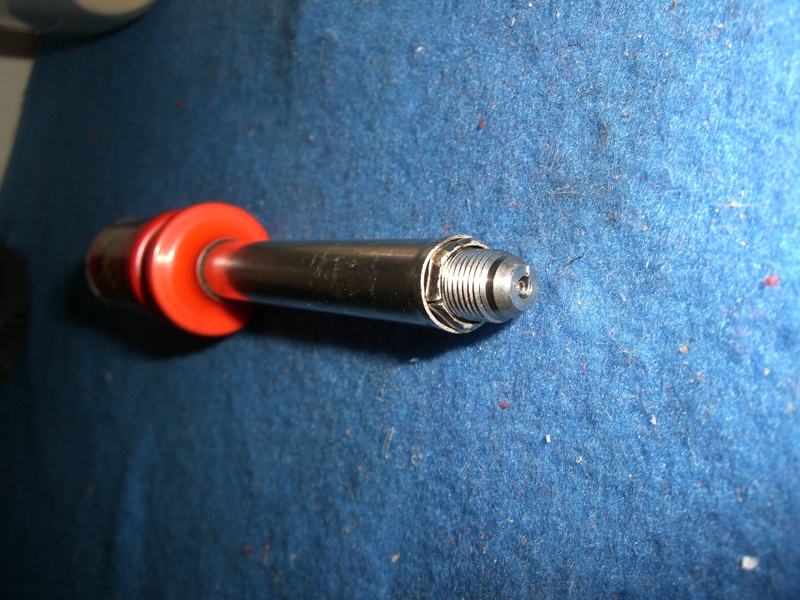

her guys and girls how do i use the glow igniter is it supposed to clamp the plug and whats the part that has a spring under the battery plz tell me how to use it

Bredrin,
1. Make sure that your glow plug igniter charge.
2. Make sure that you glow plug is working.
3. Your glow igniter still clamps down, the spring is internal. Push and twist, so that it locks onto the glow plug in the head. if the glow plug is not standing by itself, the igniter is not on.
4. Do not leave the glow plug igniter on. It will kill the battery of the glow plug!!!
See the picture. If you need anything else, just PM me. Likkle more.

Yes, If you have one with that. You have to squeeze it down to open it, so the mouth / opening part gets bigger to receive the glow plug. then release, so it stays on. which glow igniter you have.

ty so much for pics i have the ofna glow igniter that comes with the ultra lx 1

ok ty i got it now ty so much i never knew u had to push it on so hard
