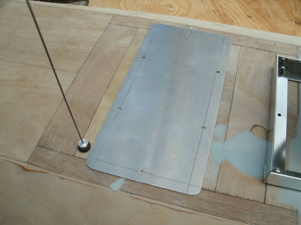

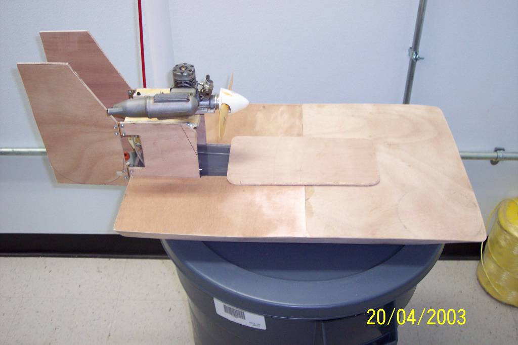

Removable waterproof hatch.
I ran my boat runs and handles great however was out messing around in 30 degree water everything iced up only had throttle control later ( 1 1/2 hours later to walk around lake to recover boat).
There was water inside the rx and battery area as well as servo's filled with water lost both and had to replace Rx and battery.
Any help would be great the cover that I have is screwed with 8 screws as well as silicone around the cover.
I need this to be able to be removed to charge the battery and on off switch.

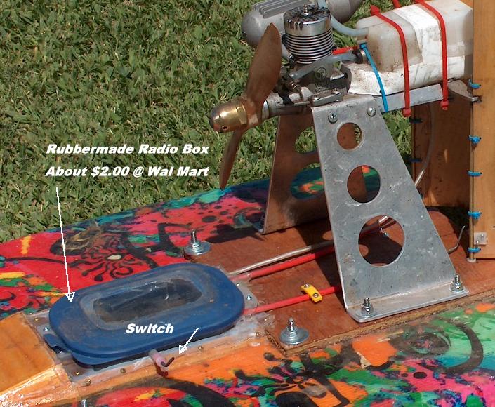

I use a Rubbermaid container.

There's 1 item not mentioned here is waterproofing the wood inside the airboat. I use thinned epoxy on the walls, floor in each compartment. I see by the picture where cover lays on top of everything. Best to inlay cover so you have a smooth surface so water can flow right on over.. I know it sounds like a pain in the butt but sure beats buying equipment if you don't need to. Ok, i looked again real hard and answer is where plexiglass ends. Answer to that is to glue another piece of wood where rudder wires come thru. Just glue a piece of wood, not a whole piece , so it is flush at top and down to or close to top of wire. Next, i would cut plex so it ends in the middle of the support piece, then where indented area should be extended all the way to the plexso cover will lay down into indented area and tape the seams. The way it is now , your letting water flow right on in. Not chewing you out but making life alittle easier. Now on mine , i cut ply wide enough and glue under the top so when lid is put on it lays flush. I just do all 4 sides and tape. I've done this for quite awhile but mine are electric as gas motor are taboo!

The pics aren't super clear of that cover you made - is sitting on top of the hull or recessed to be flush with the rest of the hull? If it sits on top currently, I would find a way to recess it to be flush with the skin of the hull, and use Radio box tape or clear packing tape to tape around the edge.
You can't see the packaging tape in this picture, but the cover is flush with the skin and sealed all the way around. The skin/cover is only 1/32" birch with epoxy on both sides. Not strong enough to screw it down so I just tape it. I bought a roll of Radio box tape for $4 which is a lot stickier than the packaging tape I was using. No water in my radio box ever, and my control cables dont even have pushrod boots on them.
