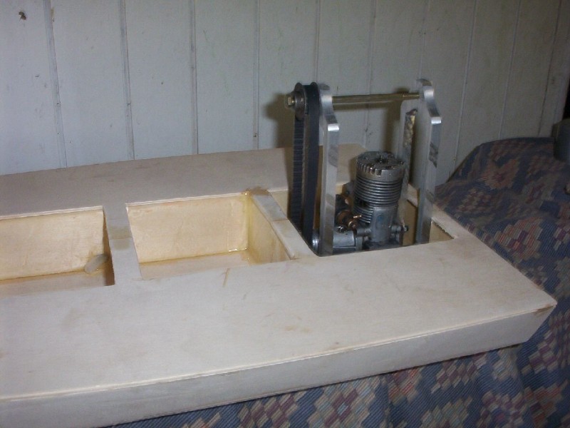

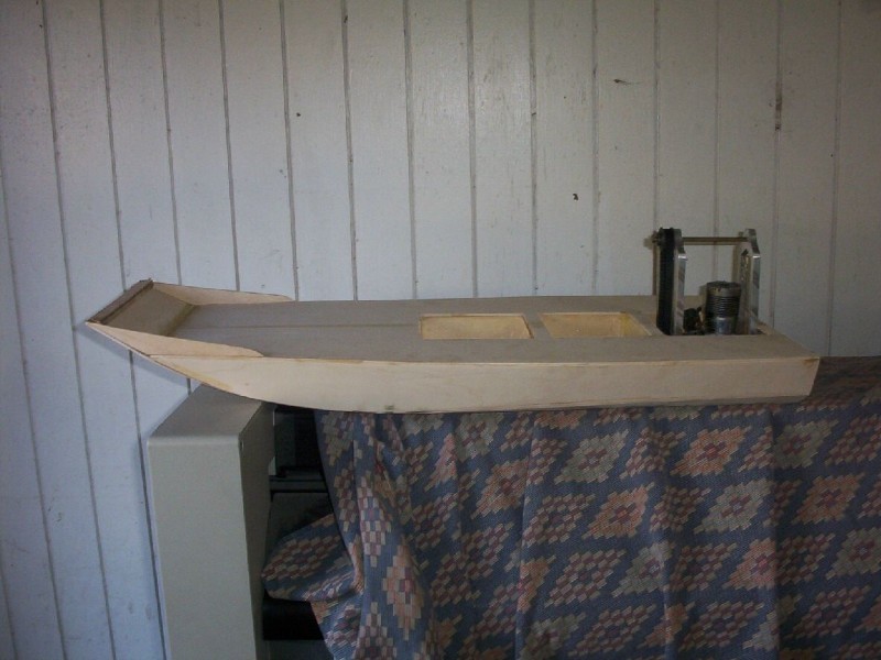

progress of DES.

What are you planning to use for the prop shaft?
What kind of bearings?
I would also try to find a thrust bearing to help take the load off the mount and get more usable rpm's on the shaft.
You may also want to consider some kind of bracing (horizontal-from front brace to rear brace) to connect the sides of the upright mounts. The thrust of the prop will want to push the rear upright forward, causing binding on the shaft.
But then I'm sure you already thought of this
Looks very good so far.[8D]

Looks Good, nice low CoG

Got to doing a little more on it. Had my first experience with a lathe, needless to say it took a couple of shafts to get it right. And first with a milling machine, to set the bearings.just wish my bit was a little smaller to get a better fit. But in the future, I will have them done by a real machinist. Tomorrow, I'm planing to set the engine. Then set the stand in the boat, then the fun part deciding on how to install the rudders and roll cage.

For now the gearing ratio is 1:1, it could be changed simply, by changing one of the pulleys. With a different ratio, a lager prop could be used, giving more control of the boat.

just bench tested. I need to make a shaft with left hand threads, or find a better way to lock the prop nut and starter cone. It looks as if the belt is going to hold up for a while, but I will be trying belts made from different material.
Thinking about drilling and tapping the nuts in place. The prop can be drilled and pinned, because I have a nut on both sides of the prop. Any ideas??

Got the nuts fixxed, I drilled and tapped and installed a set screw. Now something else has come to make me a little concerned, with the prop behind the engine, not enough air is passing around the engine to keep it cool. But this is just from running it on the bench, may be in the boat it might be different??

doing more bench testing. With every thing in line and true, it works great. But I got to thinking about, the times that "something goes wrong" and for what ever reason the boat is out of control, flips or hit something. The DES gets bent of line a little. What would happen?? So I set up the timing pulleys out of line, so that the belt is binding a little, and I set one timing pulley rubbing against the frame, to make it harder for the engine to turn the prop. Result, the belt did not hold up. Keeping in mind that the frame is made out of 3/8" aluminum, it will take a hard flip or crash to bend it(it can happen). The belt that I used is very light weight and cheap. Back to work, on the next set up, I have several things I will be trying. Then after(and I will) I get every thing working so that the worry of the belt breaking, out in the middle of the lake, is no longer a big issue, I will make a package for you guys that are wanting one.

Trying to cover every thing, that may go wrong. After all of the bugs are gone, I will make it adjustable to match up different engines(may be???) and I will make the belt tention adjustable. I'm also looking at installing rubber buttons, to help with the vibration.
