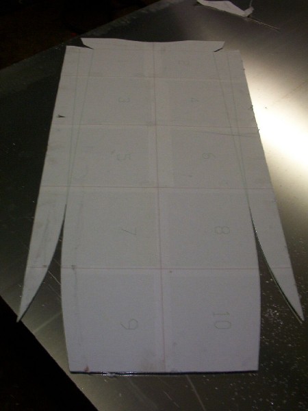

Bsmooth, I reckon you have done seen some of my pics or the vid that my Buds Terbo posted for me. I imagine that soner or later I'll be trying something dumb with it LOL.
Its started

hey haljmac could you send me derections on how to make a template out of paper like the one you posted as a pic,
also i need ideas on how to mount a .19 engine, i've tried, and failed and am now seeking advice

ModelMann
The way I made the temp. on the pic is from auto cad and a printer. Best I can say on how to do it with a pen and paper is to go to the post on airboat plans, and get the numbers there. To give a detailed step by step would take some time, latter I'll try to get it, the wife is on my case about spending too much time with the boats. I will also try and get some drawings on how to make the stand from aluminum.
