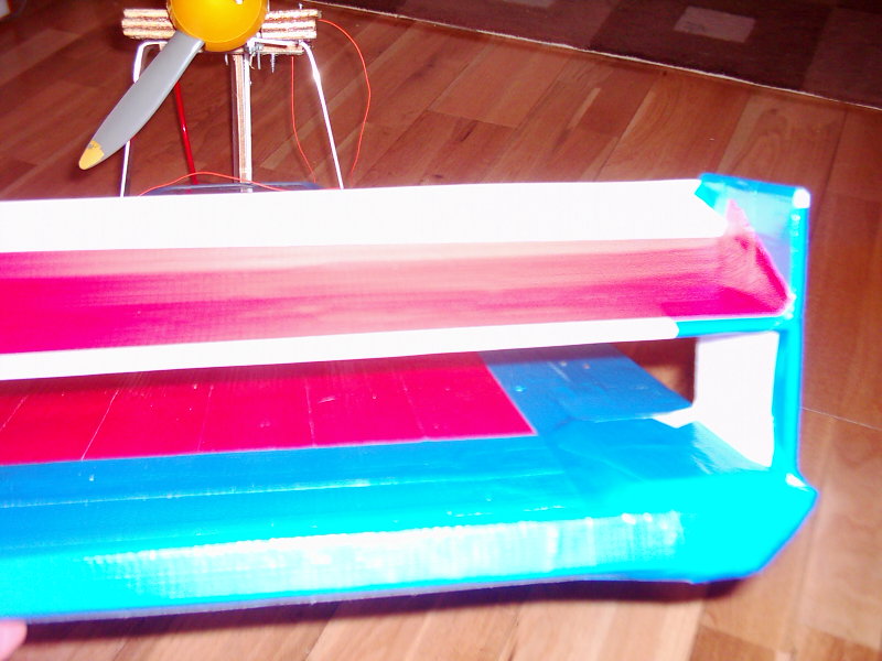

welcome im sure youll get the help you need as i did just dont expect to get too much speed or youll find out pretty quick these things flip like crazy!!!.good luck with whicever way you go .i built my 1st airboat some weeks ago now and its a blast to drive after the 1st maiden when she fliped right over i added some mods to her and shes now more stable !!.she has an os 46la engine and so far i havent got above half throttle and shes well fast ,MAYBE IF I GET SOME CALMER WEATHER ILL SEE WHAT SHES GOT !!![img][/img]heres a cpl of pics shes foam covered with thin coro.the airfoil was to stop her flipping (thanks jasper) so far im getting arround 25-30mph out of her without flipping at a guess.im hoping to get some video of her this weekend see my other thread 1st airboat maiden ill be posting it there.also take a look at the plans for the gator boat im building one for a 61 size engine !!.

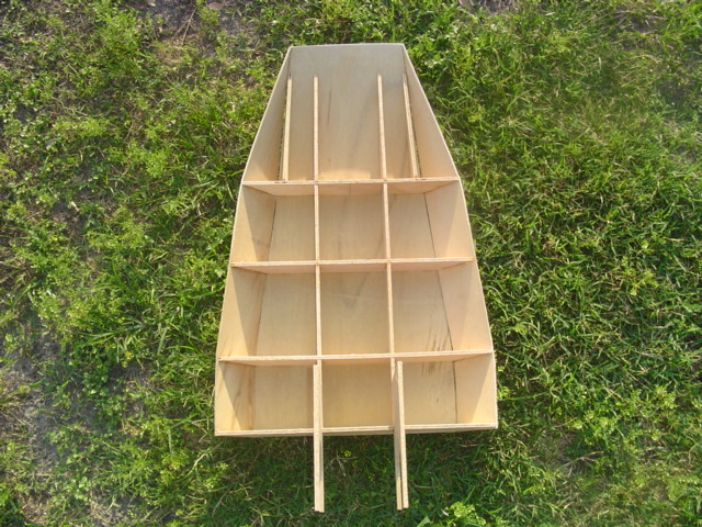

i need help
i was woundering what the frame in an airboat (a picture of the inside would help alot) and how heavy the whole boat should way with a .40 on it, with out gas in tank ,here are the sizes 26",12",2
thanks ,CHRIS
ps. how far should the motor by mouted foreward

My props swing 4" - 8" from the transom forward...depending on which boat I'm doing. For a .40 try to stay around 4 - 4.5 lbs. Try to stay with a 3-5 lbs per hp/weight ratio....depending on what .40 you use. (a bearing or bushing motor)
Here is some pics for you.
