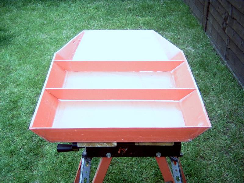

[img][/img][img][/img][img][/img]
Ok this is how far i have got , it is plastic and each compartment will be air and water tight , a bit more work to do before i put the top on

Nice work! [8D]
It looks like its gonna turn out to be pretty light. I'm gonna suggest using a .46 on your boat. If you use a 3 1/2 to 5 lbs per 1 hp ratio, you'll get good performance and response from your machine.

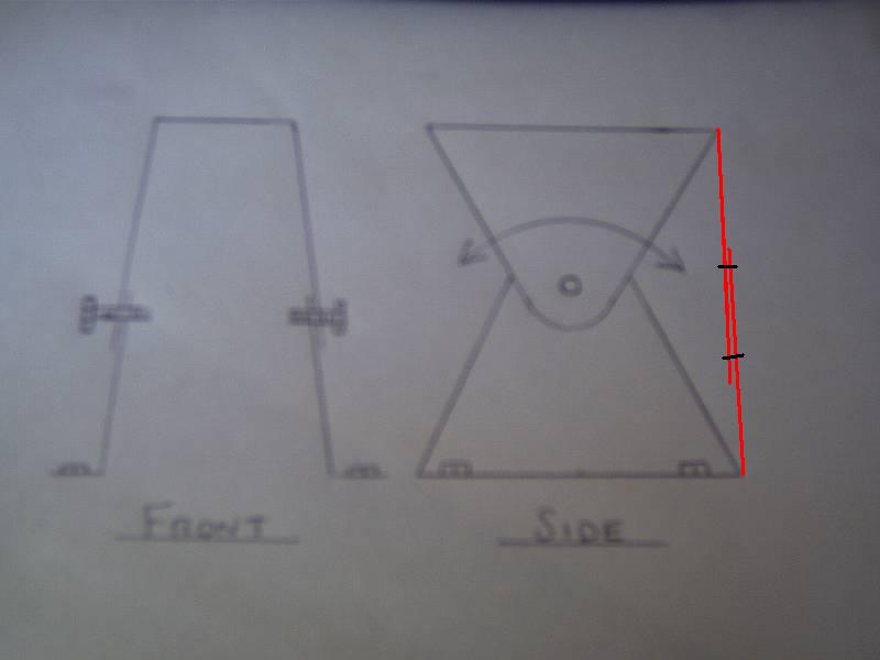

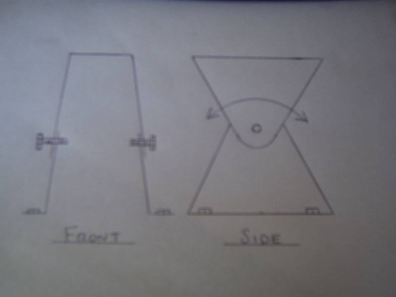

I was thinking of making an engine mount like this , so that it would be easy to adjust and set to the perfect angle

Thats a good idea!

I like your adjustable stand idea. You might want to add an adjustable brace to the back of the mount to keep it from flopping forward or back if those pivot points get loose.

100% with you on that jasperrc, I will not for one second trust just the 2 pivit screws to hold the engine in place. It is very important that your engine mount can be lock down tight. I will say that you are on to something with the adjustable engine stand, throw in a 1/4 scale servo, a couple of cams, and a 3rd channel radio, then you would have a boat that would have a good take off, top end and one that would be hard to get stuck.
I'm not sure on your plans of connecting the stand to the hull, I recommend haveing as much as possible of the engine stand legs tied into the hull. On all of my boats the engine stand is connected from the transom all of the way to the grass rake. Just keep in mind that the engines may be small, but once they are loose, they are some mean sons a guns.

I am 100% with you guys aswell , the plan was just to show the type of thing im thinking about it needs to be made safe

The idea is good , but , I would try more with TWO points .... one being a stationary pivot and the other being an adjustable pivot , which , would also give a fellow ( or gal ) the same advantage . Look at the next symbols and then think
