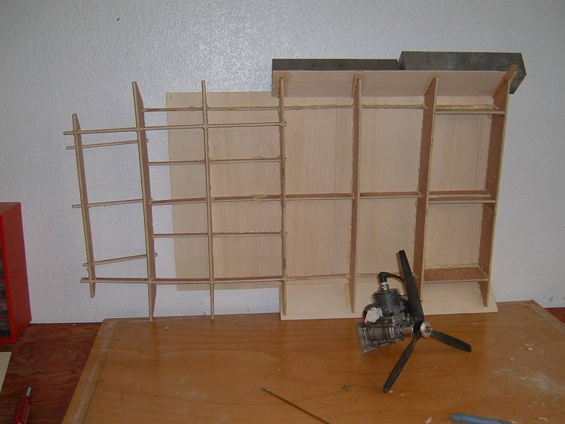

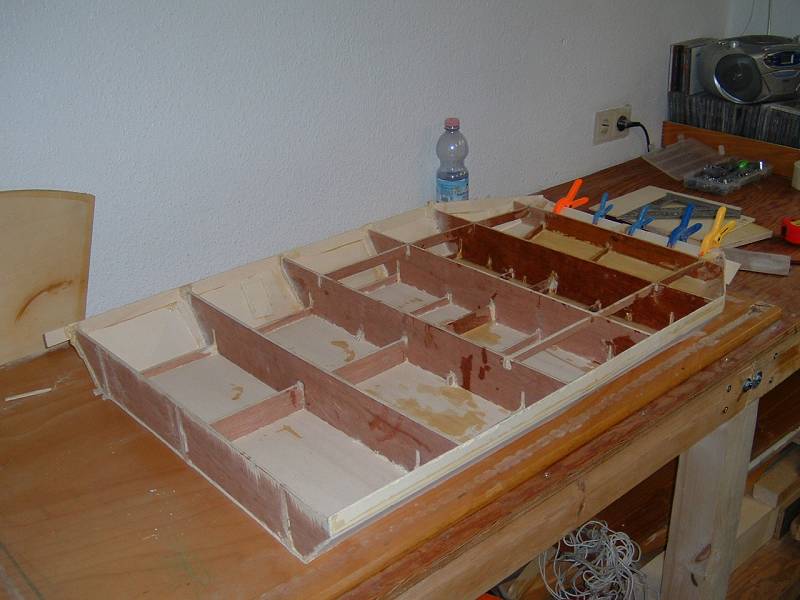

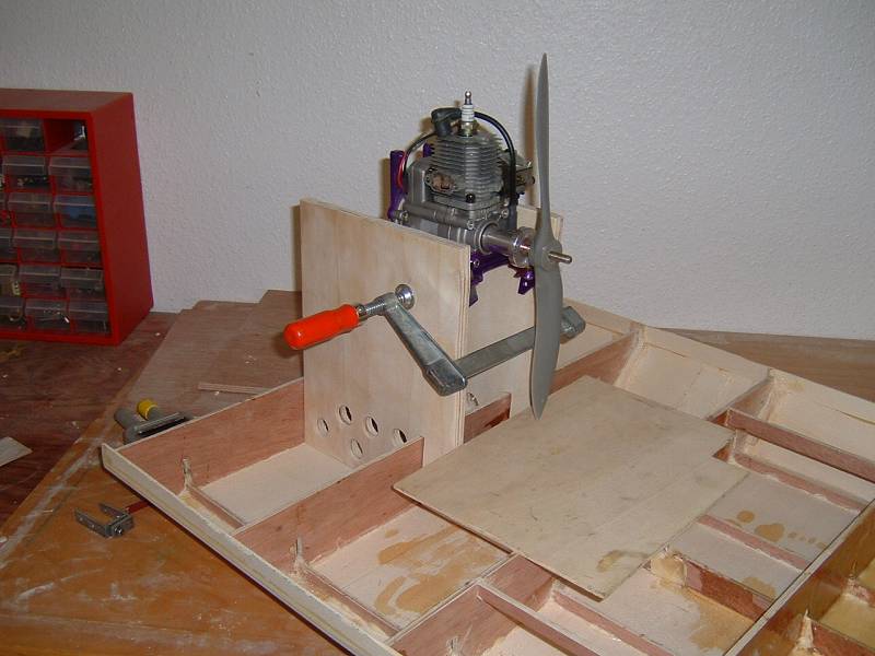

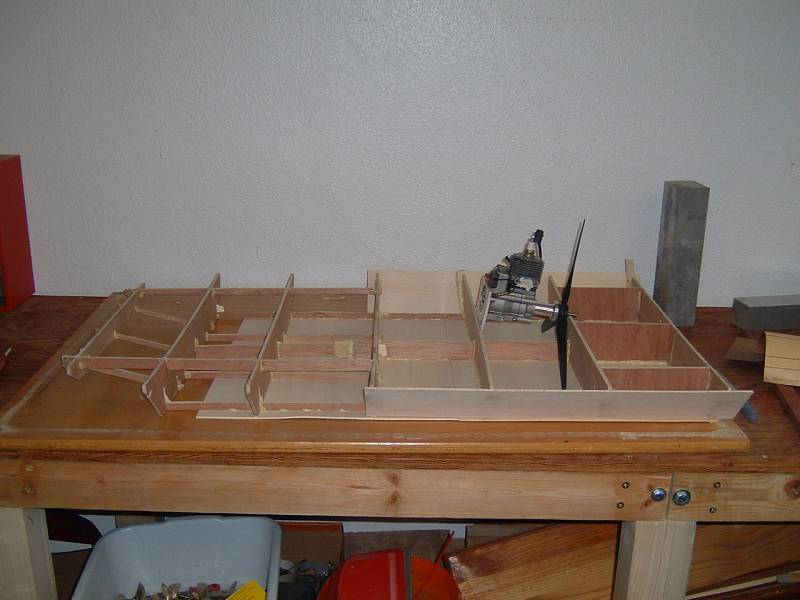

Hi gang.
First of all, many thanks to you for the wonderful ideas. Its good to sneak in here & see whats going on. Even have a lot of your pics printed off & posted in the shop for reference.
Some of you might remember me asking questions a year or so ago about scratch building one of these boogers. Actually its been in the works for about six months now and is to the point I feel confident enough to post some pics. A new work bench has helped with the process. Having one bench means moving projects around and it gets tiring.
Here it is. Don't be too hard on me just yet as this isn't a show model. Its only to get out there & have some fun.
46L x 25W x 3.5 Deep
Engine is a Zen G23 and will be setup for a pusher. I've got a 14x7 three blade. Pusher props are limited in sizes but this should work enough to scoot along. I'm going to convert the engine over to a pull start as well to make it a tad easier. Wood is mainly peices of scrap 1/4" ply, cut into stringers with the bandsaw. Decking is 3mm ply as well & will get laminated with West Systems throughout.
Again, don't be too hard on me as this is a relatively cheap project and I'm not wanting to sink a lot into it. You'll notice some of the lines are not perfect & the bottom will get filled in as needed to flatten out.

I'm certainly no expert, but I'm thinking you might be a little too big on the dimentions. I think most people are using the prop length plus a couple of inches for the width, I see your using a 14 inch prop so that should put you at 16to 19 inches wide. the length could be drop a few inches as well, maybe a little closer to 40 inches, just my thoughts we'll see what others have to say.
It will have good slides on the truns no doubt. As stated above a little smaller on the boat would give better prefromance, and at the same time what you have now will run just fine. Just one thing I would change, the 14 x 7 3-blade is going to load your engine some and not let it get up to the power band for the G23, you will have better results with the APC 14 x 6 2-blade.

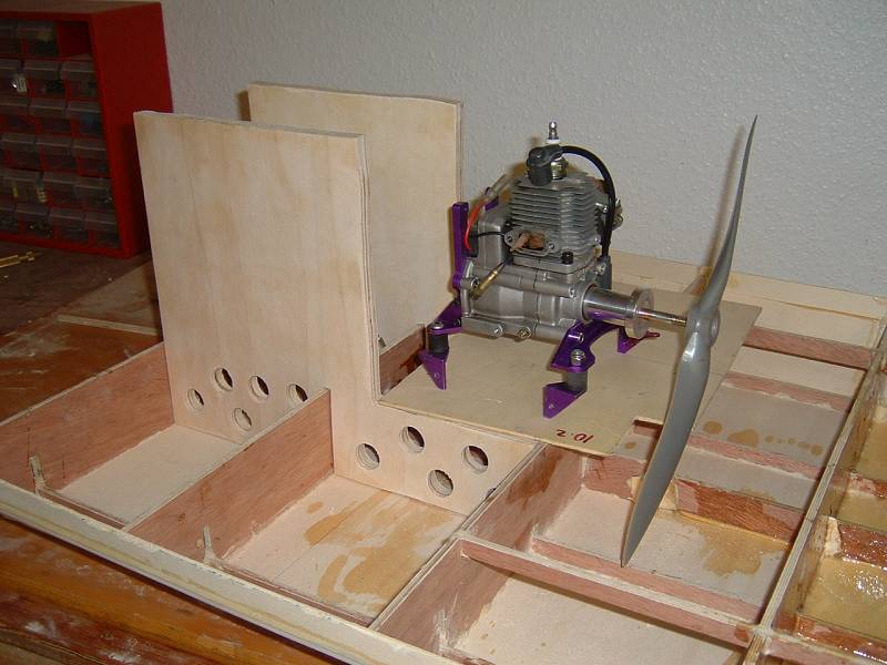

Notes taken & thanks for the responses.
To think, all this time I thought the measurements were close to where they needed to be. Amazing how you can write stuff down & somehow the numbers change when you start cutting.
If anything I can cut a stringer out from the transom. That would put it right at 40" but the width will still be there. Any suggestions. Mr Gator?
Props, I guess I'll order the APC. Being a gas boater, I'm currious to know how the G23 would act to mods? Just some mild port work. Or is it to my advantage to sell the 23 & search out a good deal on a 26 ?

As you know with the water prop on a G23 they do take the mods well, but they start to get there power around the 13,000rpm mark and max out somewhere around 17,000 to 18,000rpm's, the air props are designed to work from around 10,500 rpm's to 12,000 rpm's just below where the G23 needs to be. At the same time your boat will run ok with the G23, but much better with a G26. I have tried a few different engines, brands and sizes, so for the best engine I have found for the gas airboats is the CY 27cc. The G26 ran very close to the CY so if you can find a G26 at a good deal go with it.
The ideal size for the G23 IMO 38" x 18" x 2-1/2" the radio box would need to be 3" tall to have room for the 1/4 scale servo.
You have a good start on your boat now and it will run ok like it is.

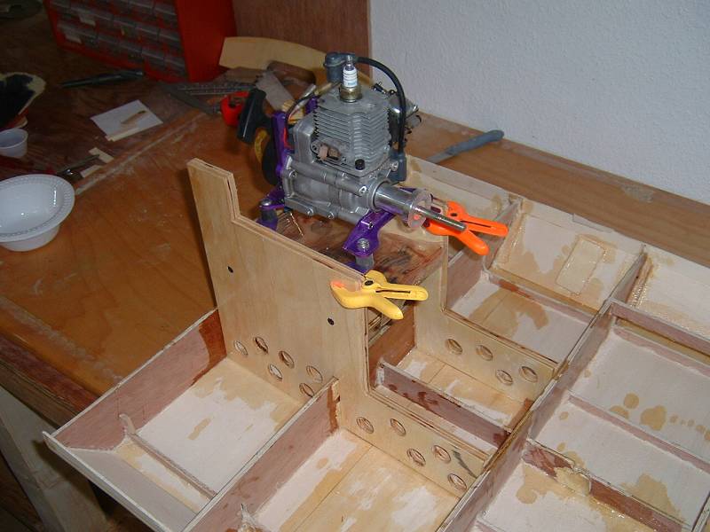

Cajun Gator & others time to pick your brains a bit more....
We've established the boat is too large for the G230PU that I have. Now, how about if I convert it over to a 26cc or even 27 ? Hull still too large?
How will that effect me in prop selection as well? I'd like to pull this 14x7x3 if possible.
Final note... please confirm some information: I've been directed that the G230PU is an easy conversion to the RC26 or even the CY25 Jug & piston. Only needs longer bolts.???
We're rolling with this & it feels good

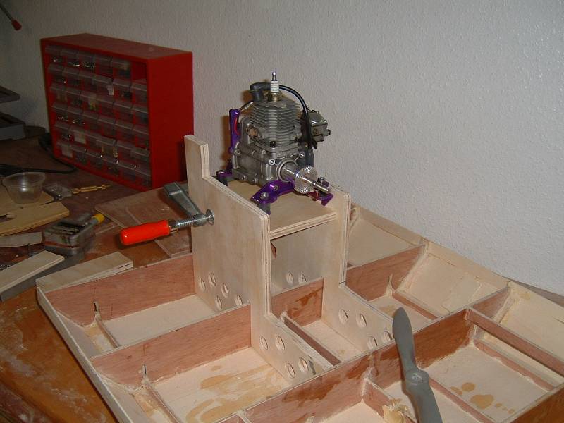

My Feedback: (48)
Joined: Mar 2003
Posts: 1,889
From: Savannah, GA

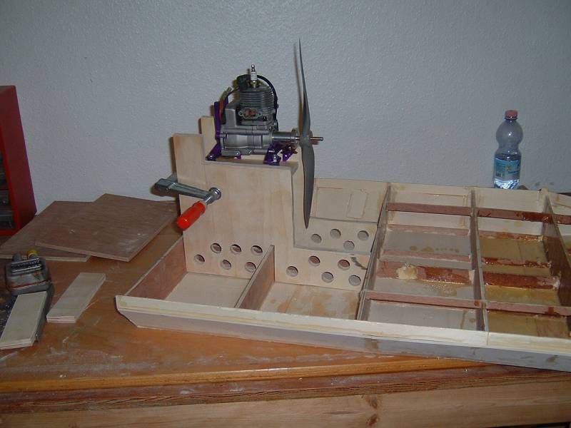

Moving on along.
A few updates and needing input along the way.
1 - I cut one rib off bringing the overall length to 42".
2 - I see now why a lot of you go with a pusher. Seems the rudder assembly will be easier to work with.
3 - Being an old gas boater, I'm going to try using a set of Speedmaster mounts. Had to change them around to get the prop clearance needed.
4 - Next is my tower issues.... Had no choice but to go with 1/2" light ply. When I say light, its not as heavy as normal stuff, but quite strong. Hope it isn't overkill. Once its situated and decided on everything, I'll cut a few more lightening holes.
Hope to use a 500ml gas bag under the engine. Other than that, I'm burned for ideas. I'll go to the shop and stare for twenty minutes at it trying to get the proper thought path.

It looks like you're doing a great job.[sm=thumbup.gif]
The angled sides are a big plus, a lot of the scratch builds don't do that.
If it's a little too wide still, say the heck with it, it should be fine.

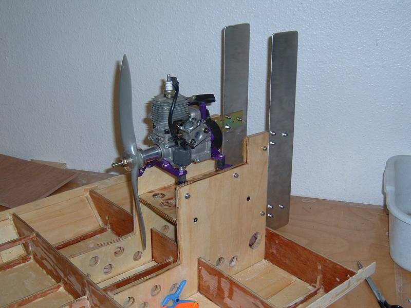

still chugging away at it.
This weekend got the tower together & epoxied in. Using West Systems 206 and this stuff is good. Look under the engine & you'll see the IV bag that just layed in there for pic's. Its a challenge coming up with ideas and now the most interesting is going to be building the rudder system.
Any ideas on how to do it? Hope to make some brackets off the back of the tower extended out to two verticle rods. Fins will be out of thick stock aluminum.
How tall should the fins be? Swinging a 14 inch prop so I'm guessing... der' 14 inches?
Btw,
Once things started coming together, its pretty dang big. Now I'm worried about the CG. Haven't put it on a balance stick yet, but by looking, it seems too far to the rear. Will try to push the radio up front as best as possible.
Btw,
You are going to enjoy this boat, looking real good. As for the CG do worry to much about that. As you know with the water prop boats, most start at 30% but on the airboats, thats a all new set up, since there is so much leverage up high. Your engine may be a tad on the back side, but again don't worry to hard. One of the main advantages to the airboat is again the leverage the engine has. At worst, if the engine was to be set level to the hull, you may have some hop. When you set your engine mounts, just set the rear mount a little lower than the front, 1/8" to around 3/16". It is a good idea to have slots where the bolts hold the engine mount, so that you can adjust as needed.
Not to sure about needing longer bolts for the new jug. There is a shim that fits between the jug and the crankcase, and it is less than 1/8" thick.
Your on the right track for the rudders, 14" tall X 2-1/2" wide. Regurlar cabinet door hinges work fine and you can still use shims to get the correct pitch and toeing that may or may not be needed. You will have to run the boat first to see if rudder adjustments are needed.
Another thing that you may want to do before decking. At the transom to bottom, this area takes a lot of abuse and it is the main area that may pop loose, it will not hurt anything to add a little extra epoxy or laminating extra supports.
Your boat is looking really good, and you should be race ready in no time at all.

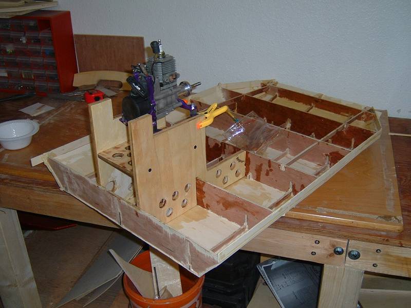

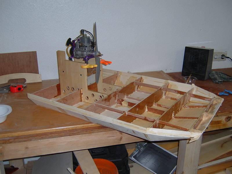

Chugging away, slowly but surely.
Got the rudders built. As Mr Cajun Gator said, I went the simplest route & used hinges. Fins are 15 inches x 2.75.
Engine installed and moved as far forward as possible.
Reinforcement in the bottom around the engine as well.
Try to overlook the stern. I'll laminate another peice on the back to clean it up a little.
Ideas needed now as to connect the fins together and for a control hook-up.
