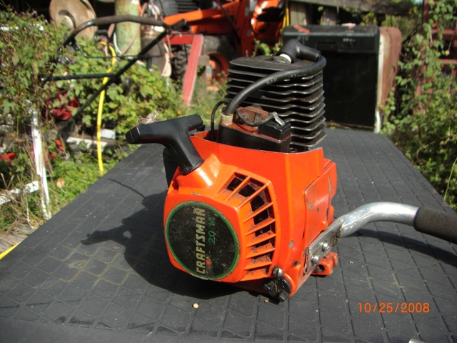

I assume that you are keeping the the recoil and using the original output shaft on the engine.
You will need to have a prop adapter made.......Could you show us a nice clear close-up pic of the shaft?

sorry guys i looked for numbers on the engine and couldnt find any i haave some pics though
ID:	1059595   Click image for larger version

These guys can hook you up. http://www.desertaircraft.com/index.php
-Gary
Old 10-27-2008 | 12:12 PM
Joined: Oct 2004
Posts: 290
From: Coshocton, OH
Default RE: servos, attaching prop to engine
All your hub needs.......http://wackerengines.com/Ryobi.htm
-Gary

ok correct me if im wrong the prop hub screws on the shaft basically rite, so if i find a prop hub with the same size inlet as the shaft on my motor it will work

Have you tried to take the clutch assembly off the engine yet? Are the threads standard or left hand threads? left hand thread would be better for keeping the adapter on , but just try and find an affordable left hand thread tap. [link=http://www.irwin.com/irwin/consumer/jhtml/detail.jhtml?prodId=IrwinProd100437]Irwin[/link] has them, no prices though.
Standard thread is acceptable as long as loc-tite is used to retain the adapter.

its left hand

OoOoOoOooo...O.K., left hand. Have you contacted Wackerengines? will they make one for you? -or-
Do you have access to a machine shop? Take your clutch piece to a machine shop and see what it would cost to have a prop adapter made with those threads. the adapter would have to be long enough for the prop to clear the muffler.

Why would you haft to make it a puller? You do not need the cover to keep the engine cool. I have made all my airboats pushers like real airboats and do not have cooling problems.
I run Gas not Nitro as far as a Prop adapter I just finished one with Left Hand threads 8Mx1.25MM for a customer with a chain saw engine for his Airboat. This Prop adapter for your boat needs to be right for safety reasons I have seen on this forum and others Prop adapter made out of plastic and other rigs to hold on a prop the RPMs are to high for that kind of stuff.
