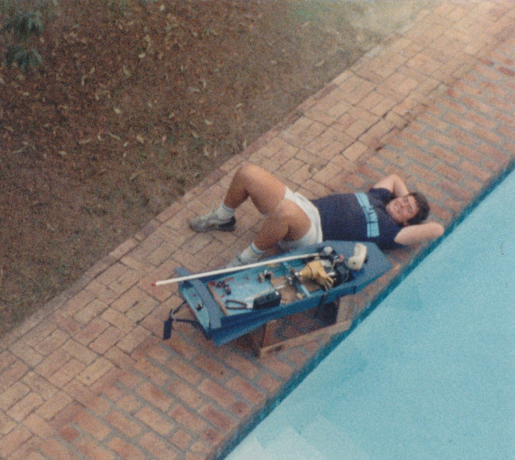

She looks a great old build for sure. You have had enough of gas motors? Should be pretty easy to locate something to work in place of the motor you have. I build something similar for my first gas boat. Basically made everything - hull, hardware, prop - you name it. Mine was desperately ugly and really did not work well - but it fueled more knowledge and creativity than probably every boat I have had since.
