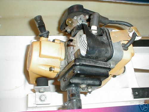

Hello,
I recently bought a gas boat on eBay. It is a Gas Powered Scarab, kit no. 1438. The engine is a McCulloch One Shot, its yellow, liquid cooled. But I have no idea how big (cc) it is... Here is a picture, it is a bit dusty, but as far as I can tell it is brand new never ran even once. This is a bit older kit. If anyone knows please let me know, thanks Alot.

Also, the liquid system is forced water, can I put a pump on like the one that is in my Enforcer to pump the water? I do not know alot about these boats, all I know is they are alot of fun!

If it has any type number on it you can find the specs on the Electrolux website.
Otherwise, just measure the stroke length of the piston and multiplie that by the surface of the piston.
If the motor has no clutch, a waterpickup in the propwash (or in the rudder) will provide enough cooling water, with a clutch you'll need a membrane pomp, that's driven by a pulse lead on the motor housing.
Look at www.shark-racing.com how it's done.
Regards, Jan.

Marine Specialties sold some Mac's converted for R/C boat use. Check their site for info.

Found out it is a 22cc, thanks!

I had a motor just like that - McCulloch Eager Beaver. I put it in my first rc boat and what a pain. The magnetos are weak in those motors, so when they get hot the motor will not run for a while. If you were planning to put that motor in a boat please don't. Your just looking for trouble. Get atleast a Homelite or Zenoah. Homelites are pretty good motors and Warehouse Hobbies sells parts for them. Run down to Home Depot and get a Homelite for $69.99. Do what ever you want, but I'm just trying to give you a heads up.

This is the Sure Shot, Dumas installed this engine at the factory, it is liquid cooled. Is that the same kind of engine you had in yours? Or was your just off a weedwacker and put onto a boat? Thanks for the info, I bought the boat with the motor installed, it has never been ran, I am actualy going to get to work on putting in the radio box and driling for the linckage's this afternoon.

I got the McCulloch motor from a local hardware store. Then, I put the whole boat together. Mine wasnt water-cooled, but that wasnt the problem of why it stalled out all the time. I just think the McCulloch magnetos are not that reliable. I "burnt" one magneto then replaced it with a working one and the motor ran like new. I think you would be happier with a Homelite or even a Zenoah. The McCulloch engines are not to powerful either, pretty soon you will want a Zenoah. You could get a cheap Zenoah on eBay or over on Jim's R/C Boat Dock. Spend the cash now and instead upgrading and upgrading later.
