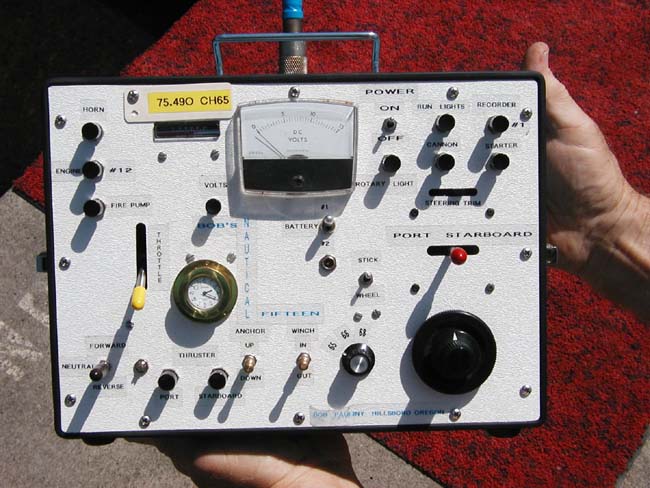

Others that I know modify their own cases and customize their transmitters.
One friend has an old Ammo box that he modified to drive his 1/12-1/9 scale tanks.

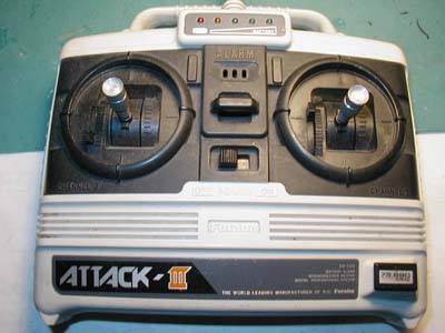

The transmitter pictured first below is a modified four channel Futaba transmitter. It is just a matter of coming up with the sticks you want.
The second one is an old Futaba Attack two channel that I rotated the right stick 90 degrees for tank controls.
