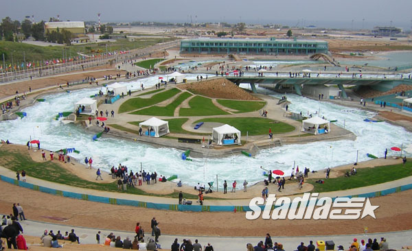

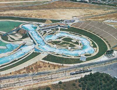

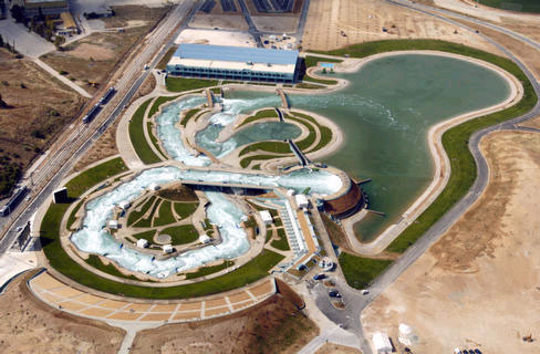

What you need is a course set up like the 1972 Munich, 1992 Barcelona, 2000 Sydney or the 2004 Athens Kayak/canoe slalom course.
The Athens course was cool.[8D]
[link=http://www.usack.org/photo_galleries/2005_slalom_worldcups/Slalom2005WorldCups/index.html]2005 world cup in Athens, Augsburg, Seu d'Urgell [/link]
Another course in Trent, UK
http://playak.com/article.php?sid=91
Does the Penrith Australia course still exist?
http://www.hydrostadium.com/angpompage.htm

that's pretty crazy,would have tobe about half the scale as those, though I'm betting that would cost a LOT of money to build, but perfect for the idea.

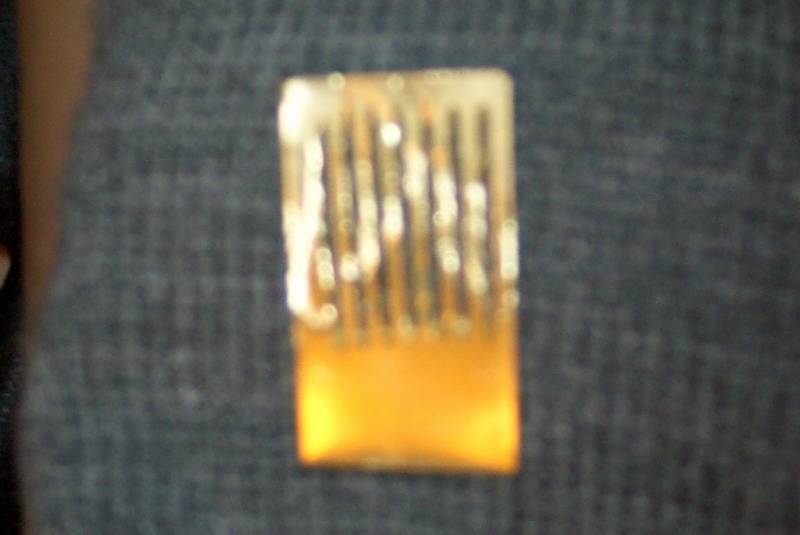

Would a Mesh Screen help? Like Fly screen or something??
Old 01-19-2007 | 07:09 PM
Quicksilver1's Avatar
Posts: 1,077
From: , ,
Default RE: Up Current Boating
yeah I'm not sure; if I make a scale intake grate, like a real boat, I'm afraid a rock could be physically pushed through by flexing the metal. Then my other worry, if I use a mesh screen, it'll make the motor work too hard and there's more chance for cavitation. I think to a degree I can accept some pebble of very small size, figuring out what size that is is the tough part.
The pebbles that have chewed the impeller were about 1/4" in diameter. Perhaps I just need something that wont allow anything over an 1/8". The situation I have is here in the NE US, all the rivers are lined with glacial stone, so the rocks are round and in every size imaginable. When the pebble gets in there you dont even hear it, it just rolls around like a BB, unfortunately like a sandpaper BB. Tonite I need something to do, so I'm going on a hunch and I'm going to take a piece of brass plate and attempt to cut slits in it. I'll get back to ya on this.

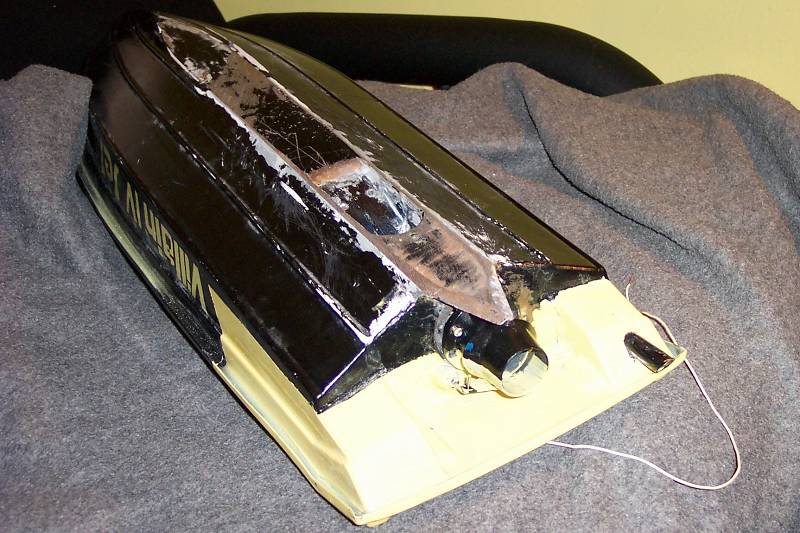

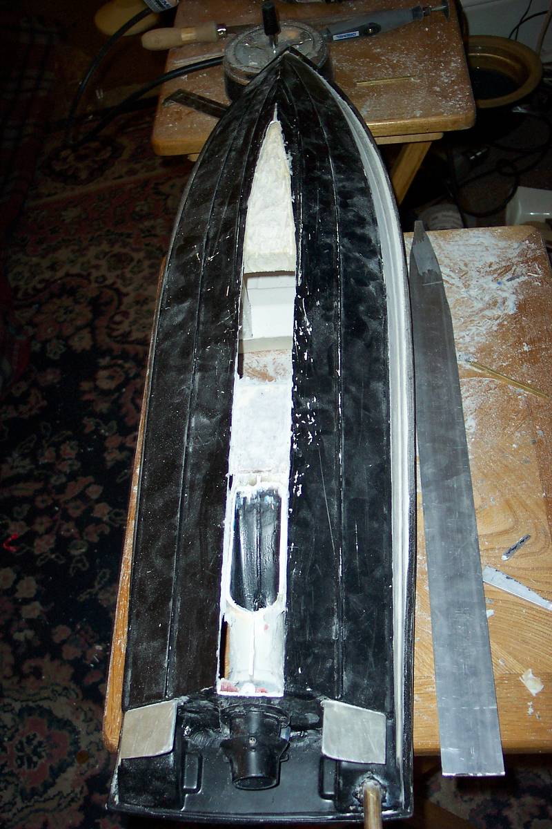

Is it possible to get a Shot of the Under side of your Boat ??
Old 01-19-2007 | 07:31 PM
Posts: 1,077
From: , ,
Okay, first shot is what it looks like right now, not pretty, but I've been doing some work trying to smooth things out. Second is what I did to the hull to get that aluminum skid plate in and third is a shot of right ofter I put the plate on. I had those intake grate bars there, but they didnt work out. And the forth pic, well I just like that one.

Ah ha! yes it can be done, brass is the ticket. I had tried it with aluminum, but it was far too soft, this was easy to cut and still feels strong. Mind you 1/16" sits too, so 1/8" slits will be cake. Now all I need is a piece of brass, I only had a small piece of stock laying around. not a problem though. Thank you for causing me to rethink this.
