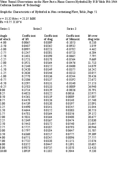

anybody know of a free program which can be used to calculate what type of wing would be needed for a hydrofoil (boat)

Hydrofoil surface area Formula
You need to estimate the area needed, so get out your calculator. The formula is:
S = L / F U² Cl
S = Surface area in Square feet
L = Lift (this is the total weight of your boat, crew, etc., in Pounds)
/ = "divided by"
F = Factor to adjust for water density, unit measurements, etc. Use the number F = 2.09
U^2 = Velocity in MPH multiplied by itself (squared)
Cl = Coefficient of lift. See the table provided below for Cl. You should cruise at a high L / D or say 2.25degrees.
Take off will be at a higher Cl & lower speed. You must make some assumptions based on experience.
[edlt]
oops forgot the table....
