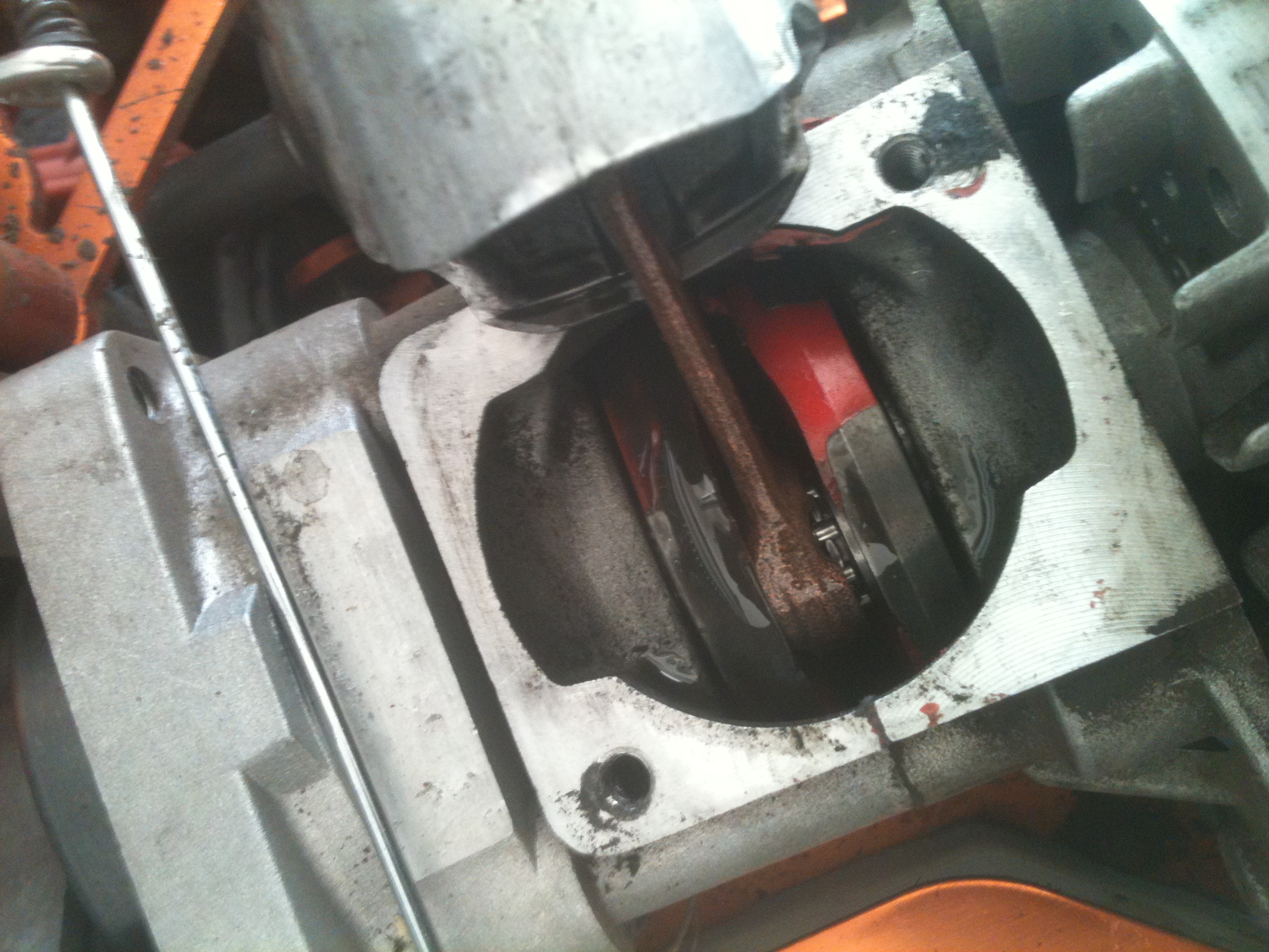

So I purchased my first clone the other day, the KM Baja with the 30.5cc.
Out of the box this thing is amazing. But I made the mistake of not going over everything, especially the air filter..
Lesson learnt.
Just thought I'd share my misfortune.[:'(]

Did the air filter fall out or something? That motor is dirty on the inside

He didn't oil the air filter. He's posting this as a lesson to everybody that runs nitro and gas to make SURE their air filter is oiled on their new ride before they crank it up.
Sucks dude, happens to the best of us.

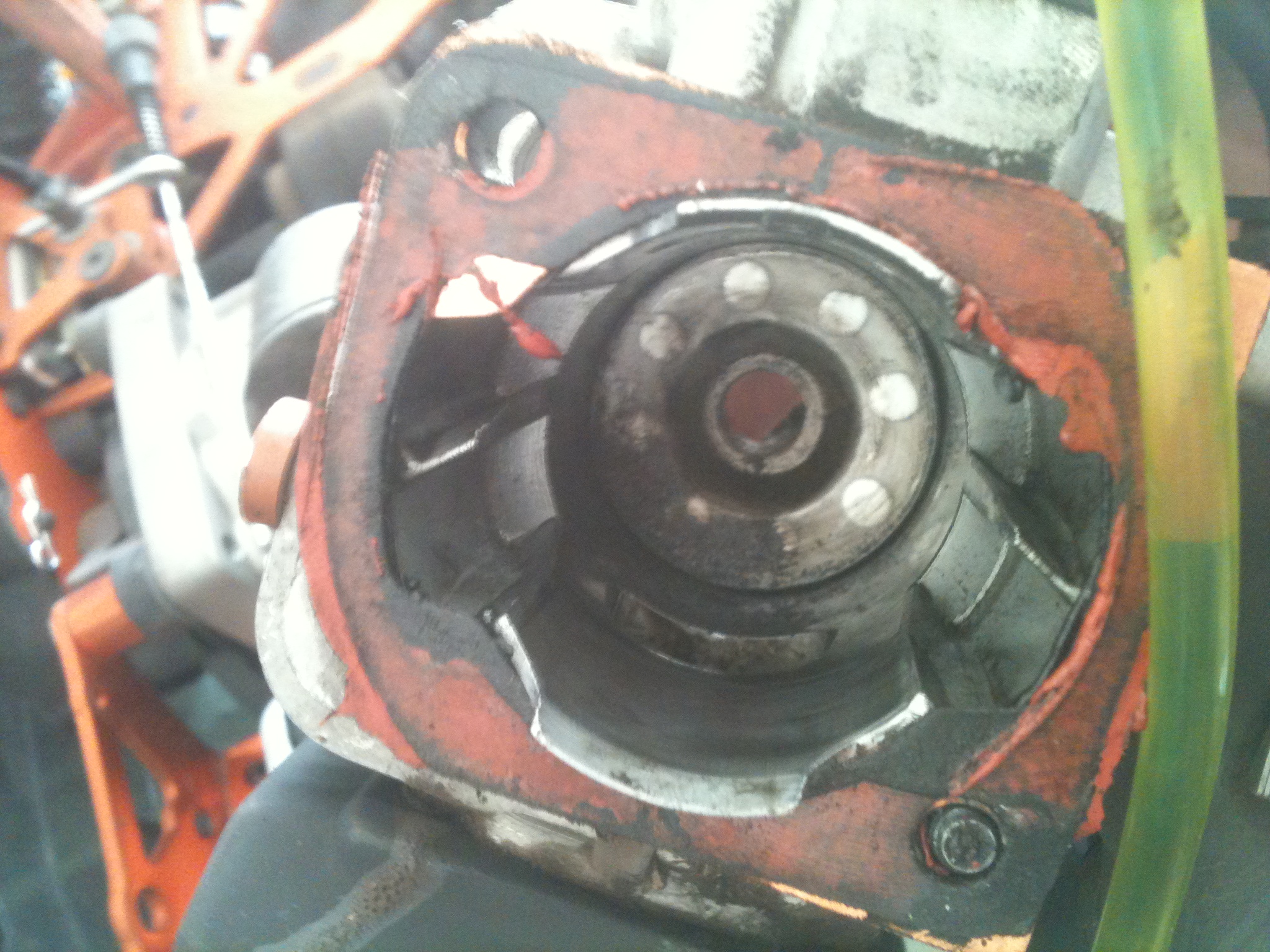

Yeah dude you gota be real careful with those things. Gota check everything over. Go hit up DDM for a new motor, get a zenoah 4 bolt. Around 200-275 bucks depending on the displacement. A lot better than the stock motor.

This is why I'm anal about my air filters. I won't even crank the engine if there's no suitable filter attached, let alone start it.

yep 378 is right about air filters. one time i for got the air cleaner running on pavment, it ran fine for a long time. but when i stoped the idle was high. checked the carb and there was a pebble stuck on the slide. if that pebble had gone into the engine i would have had trouble.
